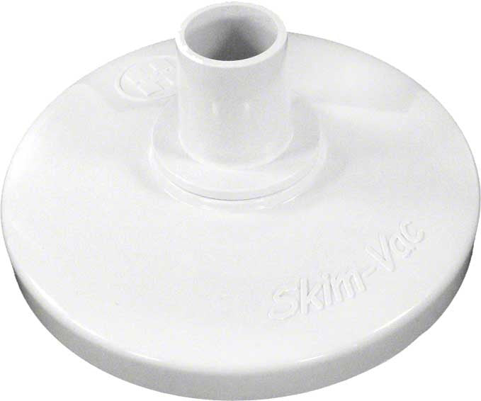

Do you have a pool vacuum rig that fits your skimmer?
You need a skimmer plate, hose and vacuum head.
