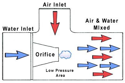

See the Jandy blower manual here --> https://www.jandy.com/-/media/zodiac/global/downloads/h/h0507900.pdf?force=1
It has diagrams that show how the water and air lines are separate and get combined at the Venturi Jet outlet. The blower cannnot push against the water in the pipes and it will not add bubbles to the water in the pipes.
Just for clarity, the above picture is not how your spa is plumbed. Your air lines terminate at the spa so it would be impossible to add a blower.

The venturi tee needs to go into the spa wall at the outlet into the spa. The water and air need to be released into the spa immediately after the tee.
