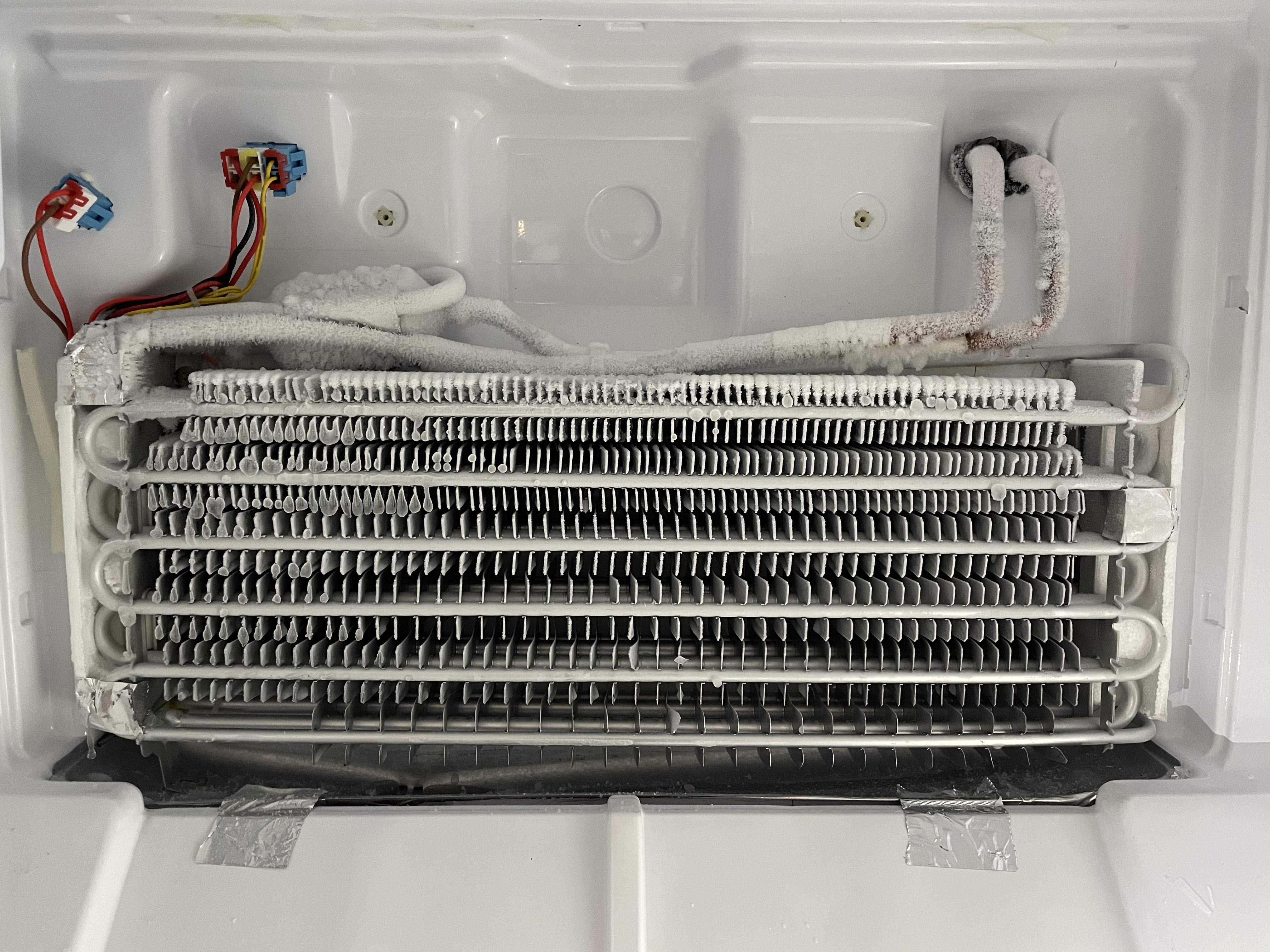

If not I could probably talk you through the heat tape fix.The little bracket was off to the side. I actually moved it over while I had it apart so that it dipped down into the drain line, hopefully that will help a little bit too. Then I added the short piece of copper wire on the outside, and one that goes probably 6-8 inches down the drain hole. I'll find out in a couple months if it works, of course.
