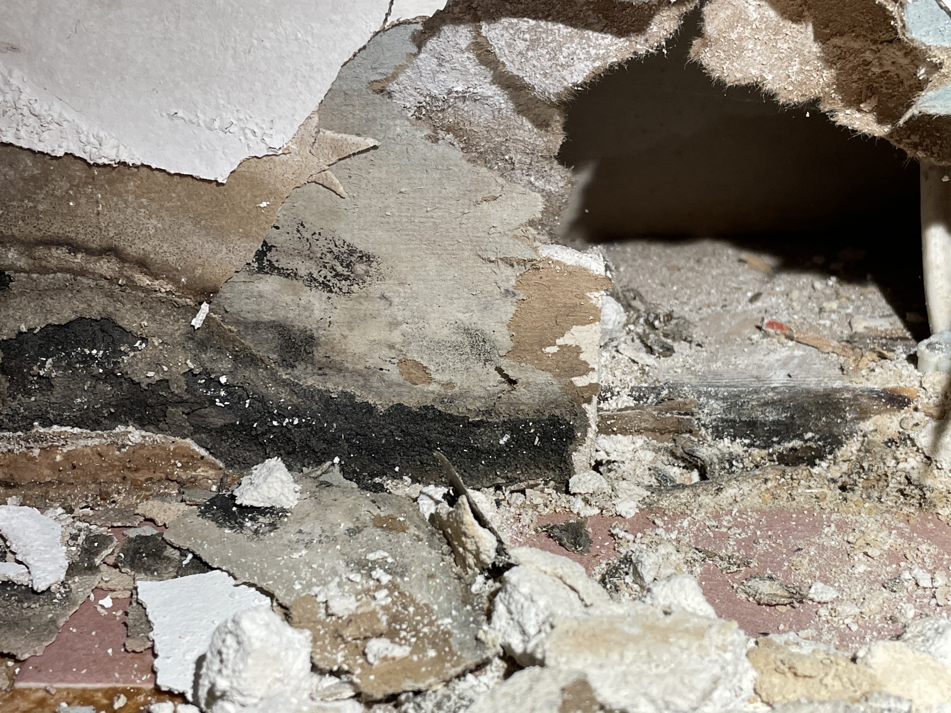

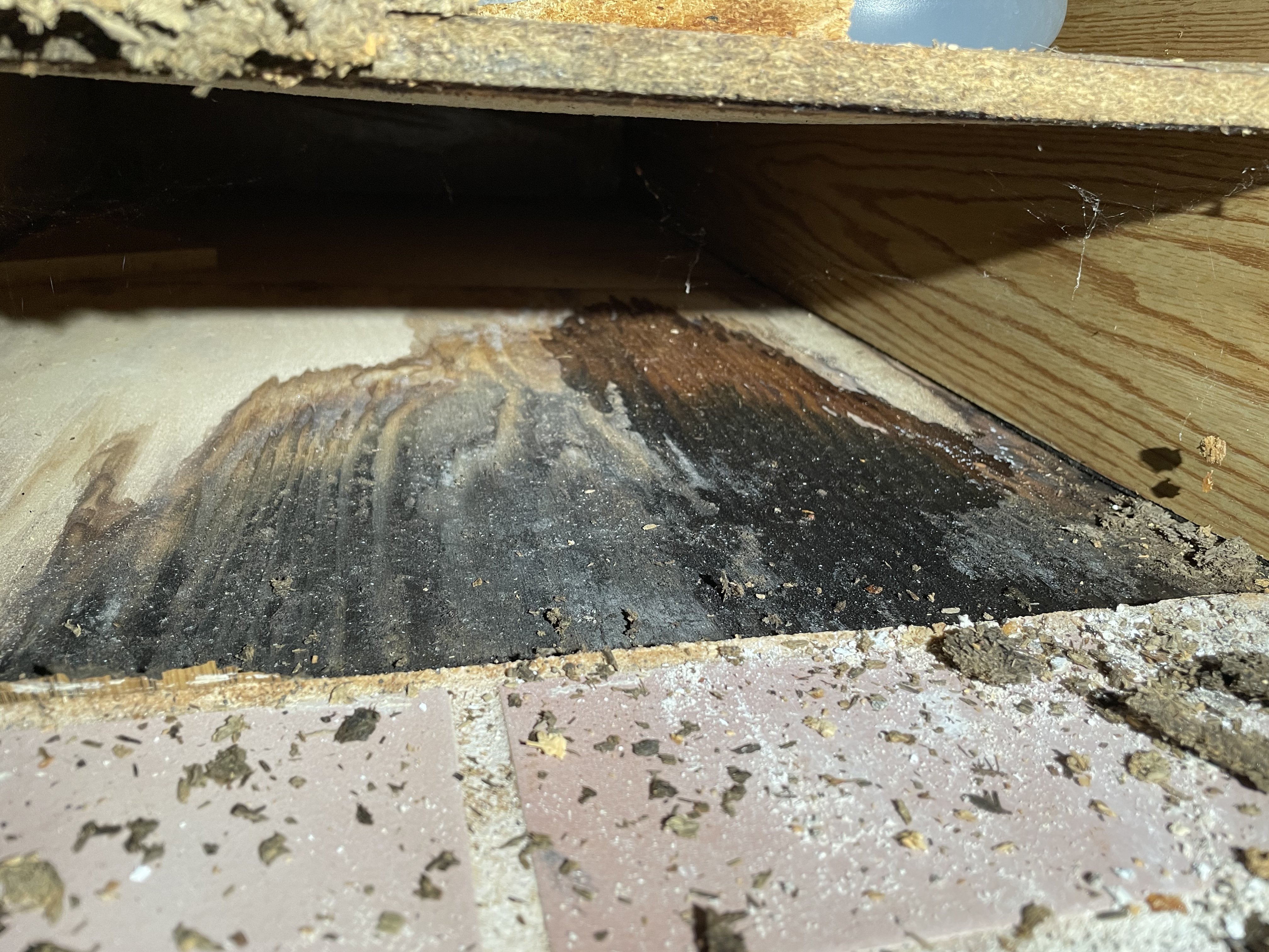

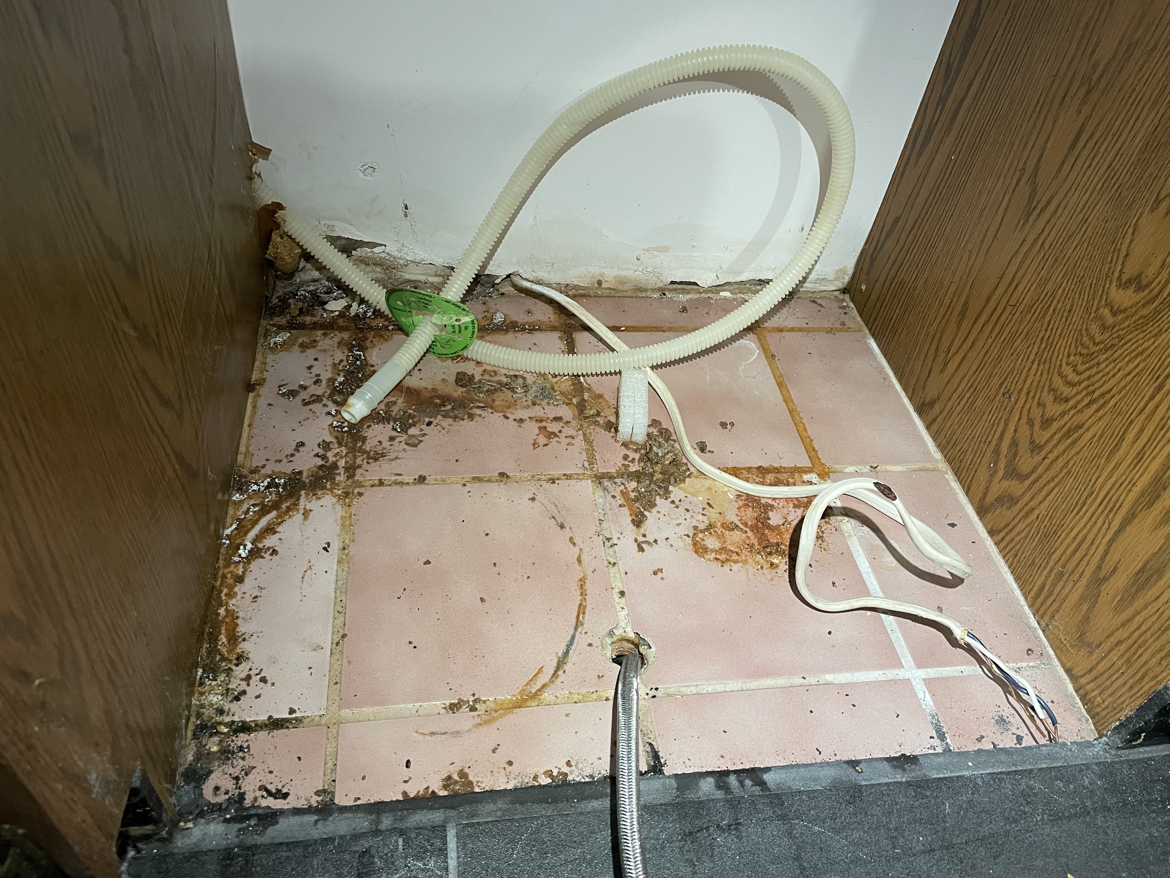

Found out my dishwasher has been leaking yesterday. Was in the basement and noticed a small spot of water on the floor. Looked up and a joint between subfloor panels was wet. I had run the dishwasher twice that day. This morning removed the kickplate and signs of water leaking for a while (dry minerals), ran a load and got an immediate drip of a drop every few seconds. Pulled out the dishwasher just now.

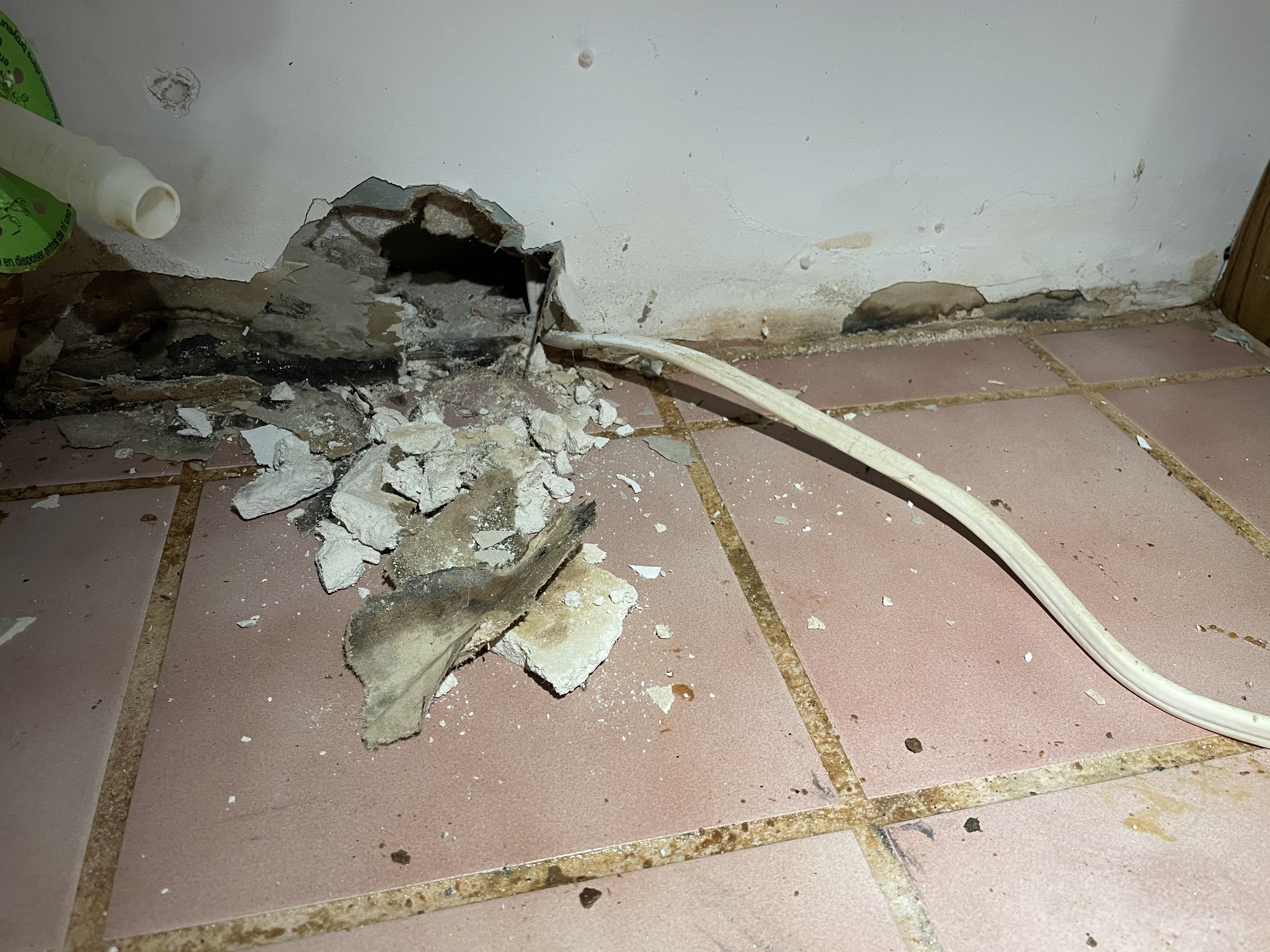

Drywall was soft so I poked a hole to look inside the wall. It’s obviously gotten wet on the other sideI also recently noticed some flooring on the other side of the wall was bulging upwards, but I wasn’t sure if I had never noticed that before or it was new. Apparently it was new...
So...anyone have similar things happen? Obviously mold is probably the biggest concern here. Not sure the best course of action to go forward. Suppose a mold test to figure out if and what types of mold may be present? (I know only a few are a big concern)
The wall behind is luckily not load bearing, it’s a 7’ wall dividing a kitchen from a dining room with cathedral ceilings, but it’d suck if I had to rip it out due to cabinets and granite countertops.
Also I think when this is all done I’ll put a water sensor under the dishwasher, hopefully catch any future leaks much earlier. Unfortunately it didn’t leak out onto the kitchen floor as the tile in the kitchen is apparently put on top of old tile, and not under the dishwasher, so there is like a 3/8”rise from under the dishwasher to the kitchen floor.

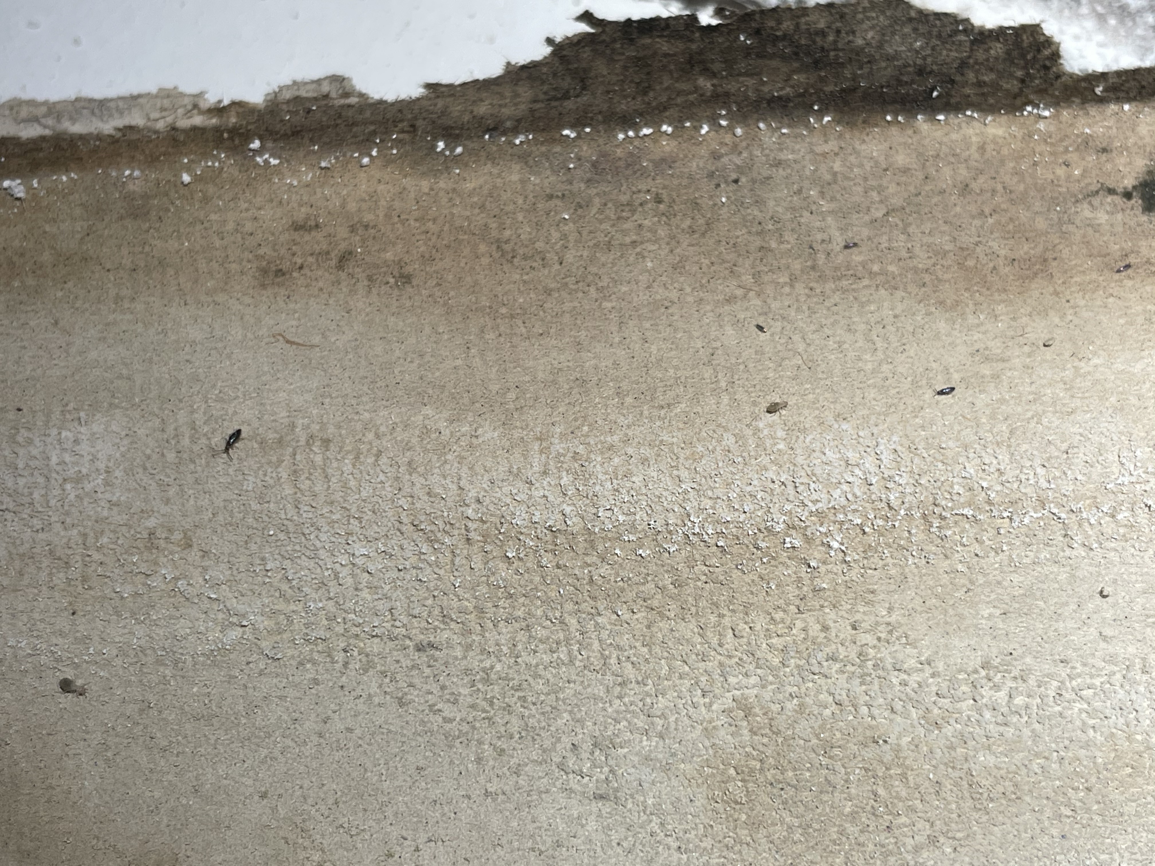

Pulled off a piece of drywall and there were little bugs crawling around on the backside.

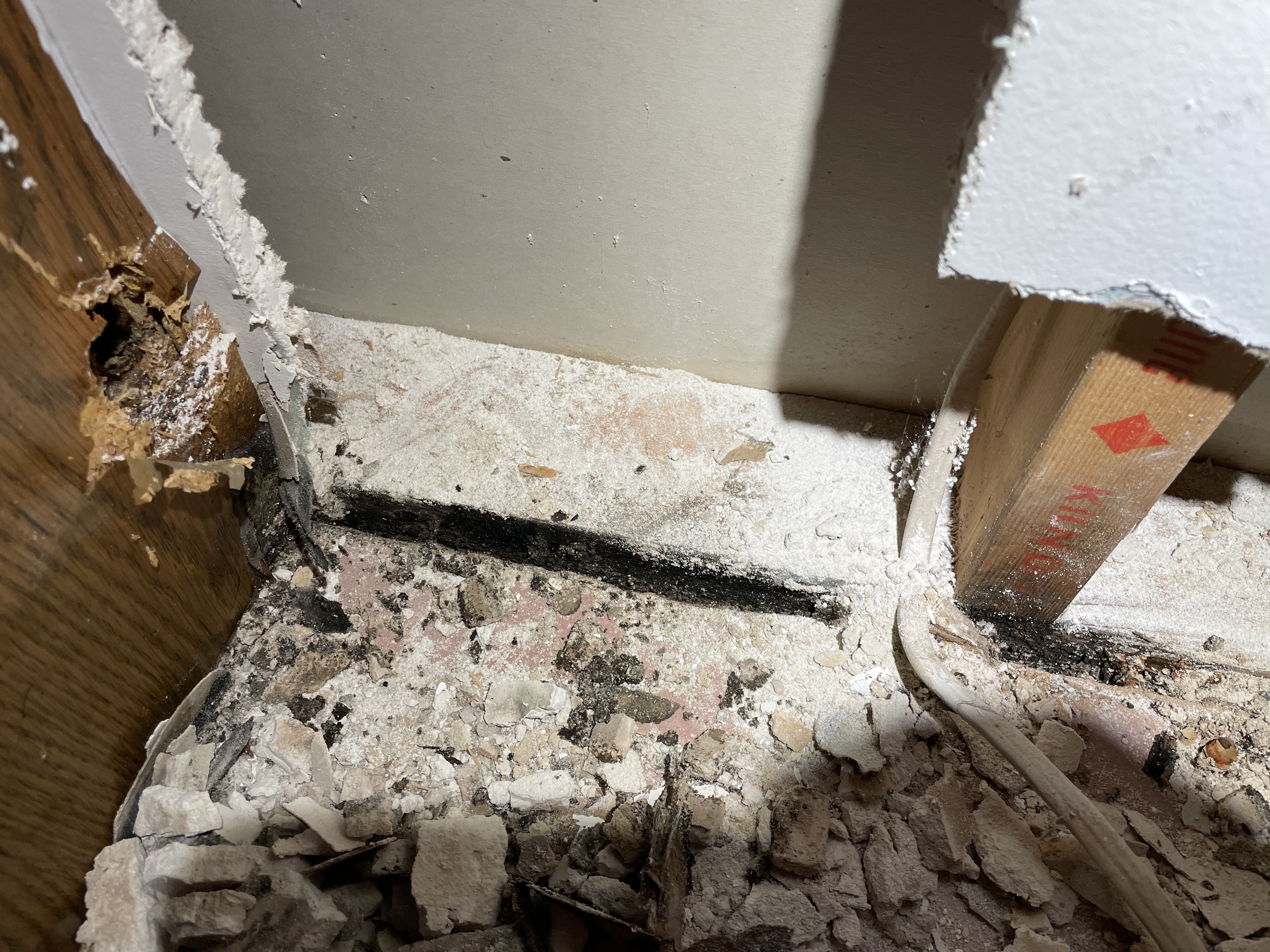

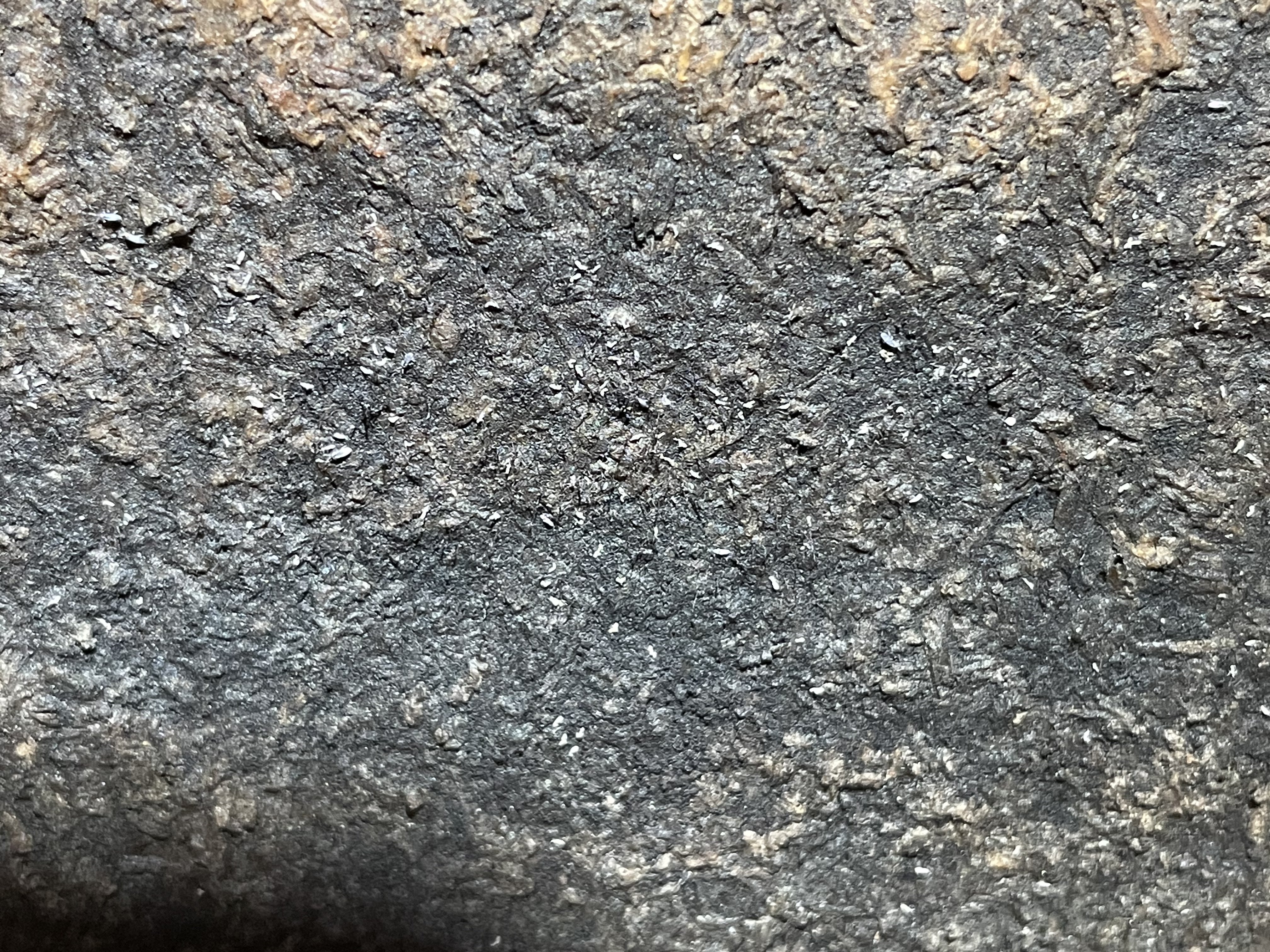

The drywall was soaked to the subfloor, as is the base stud and the subfloor itself. The wood is somewhat soft on the side facing the drywall but I don’t think it needs to be replaced. It’s obviously been leaking for quite some time though.

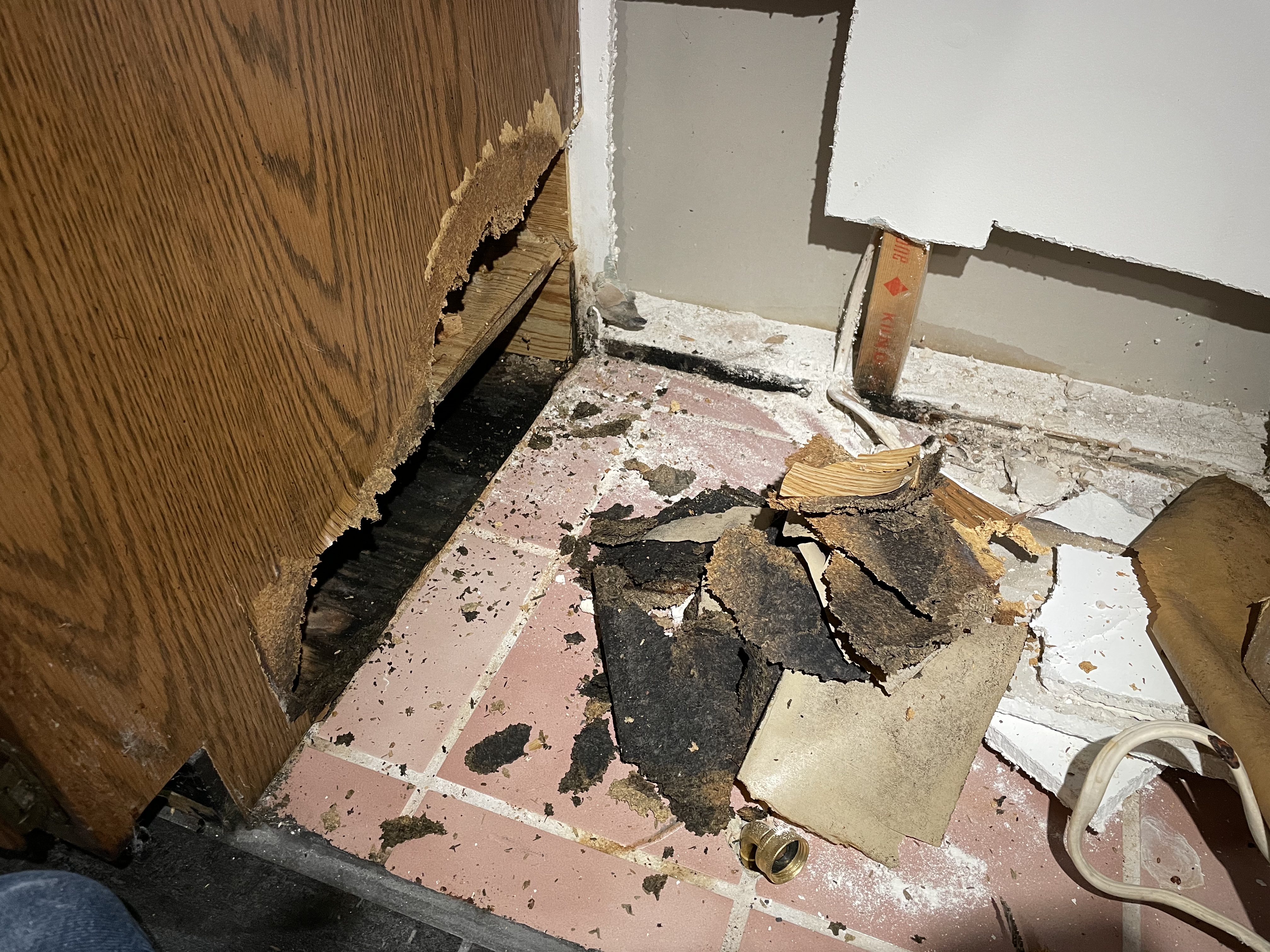

The particle board cabinet wall was soaked and damaged (particle board gets damaged quick though), ripped out the soft stuff and there were all these really tiny white bugs in the wood. Not sure what they were, not certain I want to know...
Under the sink cabinets to the left of the dishwasher.
What I’ve torn out so far.
What I suspect I need to do is tear out the thin particle board under the sink back by the drywall and pull out the wet drywall so I can reach all the wet wood and spray it/let it dry, then rebuild things. This is obviously been leaking for a while. Ugh.

As for those “white bugs”, they are highly likely termites. You’ll need to either hire a pest control company to come kill them or DIY. You’ll need to inspect all wood for termite damage and cut-out & replace anything that is heavily infested
+1. Some sorta larva for sure. Whether they grow into termites or carpenter ants is kinda a moot point. The good news is they only want the compromised wood for the most part. The bad news is you probably already had them if they moved in that quickly.
