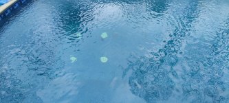

I neglected to mention that I started covering the pool with the solar blanket to try to keep the sun from messing with my slam too much. Uncovered it today to check the color. Latest test was FC of 34, and CC of 0.5. I'd describe the color as a turquoise, not green per se. Here are some pictures, but it's hard to tell from these.
Does your cover have algae on it?
