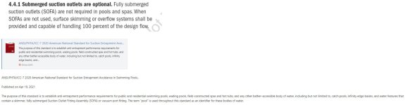

Main drains do little to nothing in terms of capturing debris. The robot will take care of anything not captured by the skimmers.
Unless there are local requirements, main drains are not needed. However, if they are installed, they obviously need to be VGBA/code compliant. I would read the actual text of the applicable regulation.
