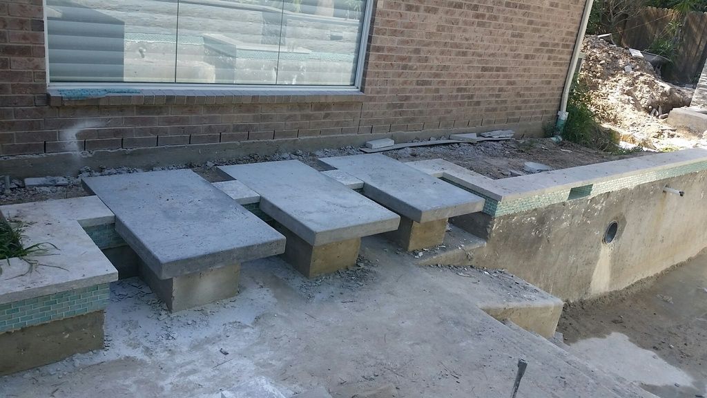

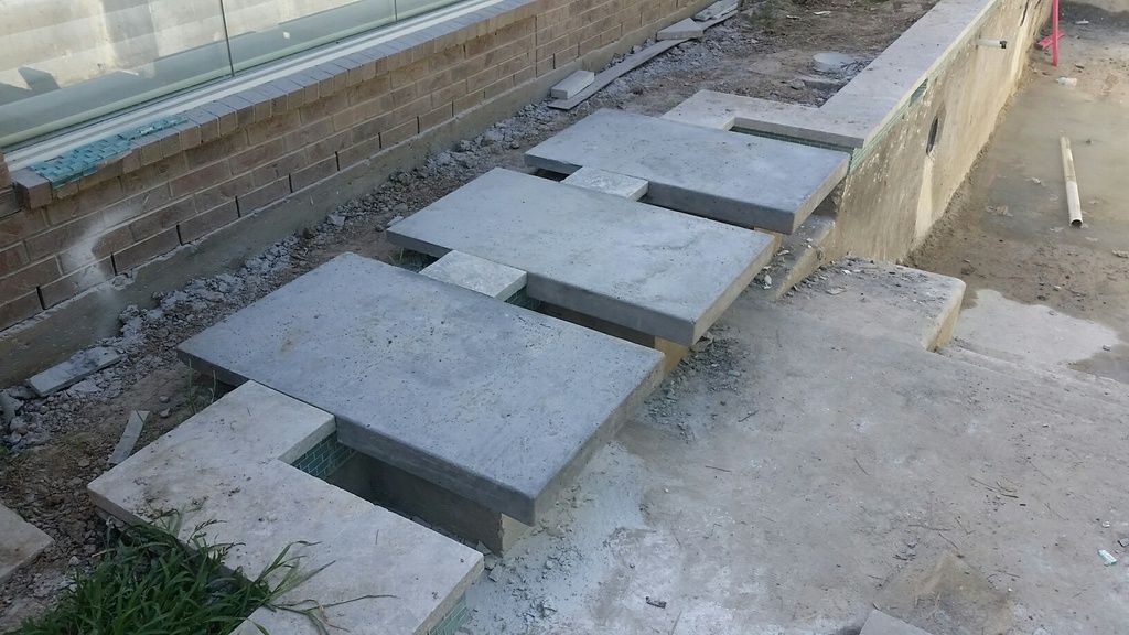

The floating steps went in. They are custom designed out of a cast concrete material. We used the same thing for all of the raised beam capstone.

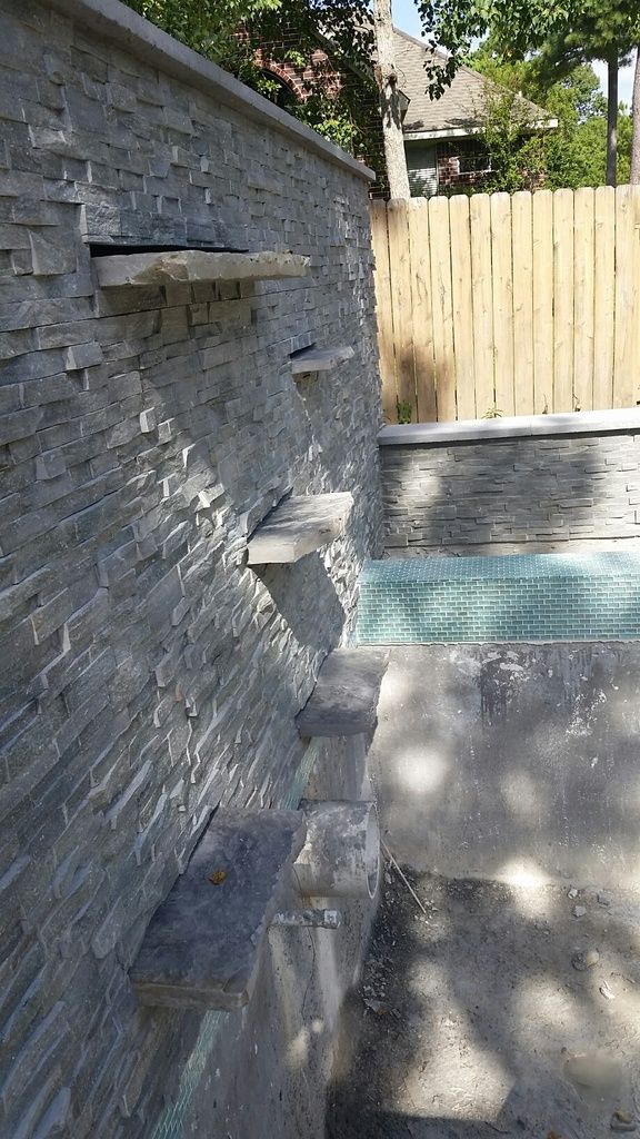

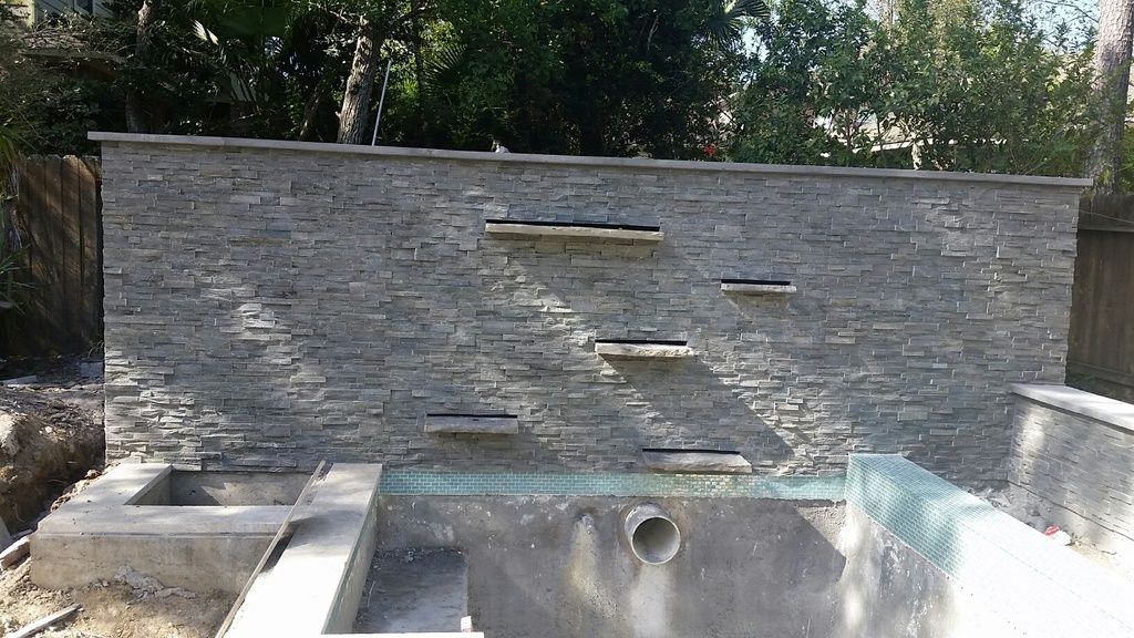

The waterfall wall got the embedded flagstone for the water to flow over.

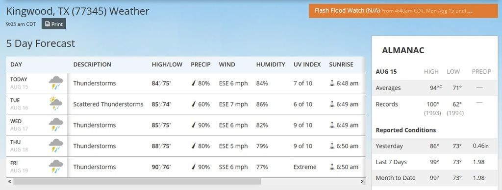

Speaking of weather.
I think I mentioned a while ago about us getting hit by lighting over Memorial Day weekend and all the damage we took. It also killed the tree it hit (70' pine) and the tree right next to it. We have a tree guy scheduled for Monday to cut them down, and of course rain is in the forecast for Monday. We need those trees removed before we get the fence redone which we want done before the landscaping starts so they don't trample it... This is going to be "fun"!

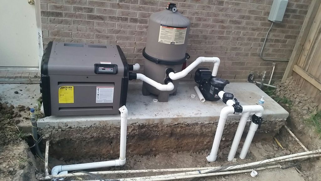

Just enough space! We weren't 100% sure it would all fit. Looks like maybe even space for a chiller if we decide to add one later on. Main pump, cartridge filter and 400k btu heater.

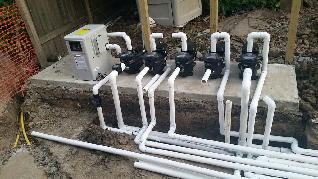

Secondary pad with water feature/spa pumps and additional 100k btu heater for quicker heatup. Air blowers need to go somewhere...
Because of the amount of relays needed on the OmniLogic for all of this stuff, Hayward was considering letting us beta test a new 10 relay add-on unit, but it was not ready to release after all so we ended up going with all variable speed pumps since they don't require a dedicated relay evidently. Kind of overkill, but we'll be able to control all water feature flow levels from the app.

Are there in pumps left to see to others in your area?? LOL
I love the fact you will be able to control every thing so you can get it just right for each mood or event.
Are there unions of some sort on those pumps? VERY important to add them now if there are not.

It just kind of kept growing. We wanted to be able to individually control all features.
As far as unions, yeah, these Hayward pumps all have built in unions on the pump housing. That was one of our plumbing design asks up front.
