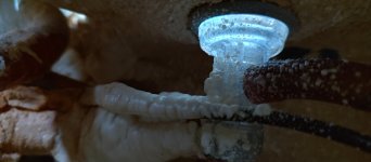

We have a jet that looks like it's been shifted somehow, and has now started leaking. I've been trying to figure out how to loosen it or remove it so I can reposition it, but the housing does not have a nut on the back like others I've found by searching. Doe anyone know how to loosen or remove this type jet housing?

I have heard about these but never seen one. It's a new press-in design, and I had reservations the first time I heard about them.
So, to answer your question, remove the tubing and push from the back. It's tight, but should pop out. Replace and replumb with minimal tension on the tubing. Splice on a piece if you must, just don't stretch it on the fitting.
