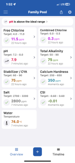

I can’t seem to lower my pH no matter how many times I add muriatic acid and how much I use. My chlorine is high as a result of an earlier slam. It’s definitely taking its time going down. My SWG is at 25 percent. Is the chlorine being that high causing a higher pH?IMG_7809.png
You cannot get an accurate pH reading with FC over 10. You can let it drift down to below 10 so you can get an accurate pH test, but typically it reports higher than actual when your chlorine is high, and a pH of 7.9 is nothing to worry about so I would leave it be and focus on your SLAM.
