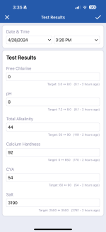

I have a salt meter, but went back and double checked and it came back at 3190. As for CYA, I just made an educated guess to get back between 50 & 60 but rounding up to 60 makes sense.
To try and get FC up. According to the app, I need to add bleach (again). To ensure I don't have some diluted, I just went and bought new Clorox and going to dump it into the pool.

Fighting with getting my FC up, I am thinking my salt cell might be acting up but I replaced it in 2021 so it is still under warranty.
