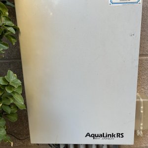

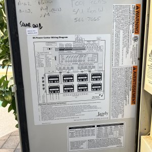

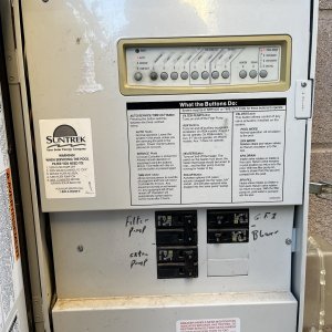

Thank you for your help. Here are a few pictures:
It should not take more then an hour or two and some PVC parts to cut at ground level the two pipes running up to the roof and tie them together. I am not sure the best way to do that since you didn't post clear pics of the plumbing around the solar valve and the two pipes.
Basically, fix the plumbing to eliminate the pipes running up to the roof. That can all be done on the ground.
