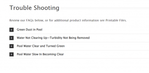

It’s just a form of zeolite media used as a replacement for traditional silica sand. It weighs less but costs A LOT more. Honestly, I’ll never understand these pool companies that keep trying to push “new and improved” which almost always “new and no better than the old stuff”. Anyway, you can look at the manufacturers troubleshooting webpage to see if anything helps -
My guess is that what you are seeing is the turbidity that comes from unwashed zeolite. Unlike silica sand, raw zeolite media from the bag is INCREDIBLY DIRTY. And it’s a kind of very fine particulate dirt, like silt, that remains suspended in water for a long time. If your chemistry numbers look fine, then you have a filtration issue and all you can do is wait it out. Please don’t use flocs or clarifiers. When used improperly, they can wreck the filter media and cause an even bigger mess.
