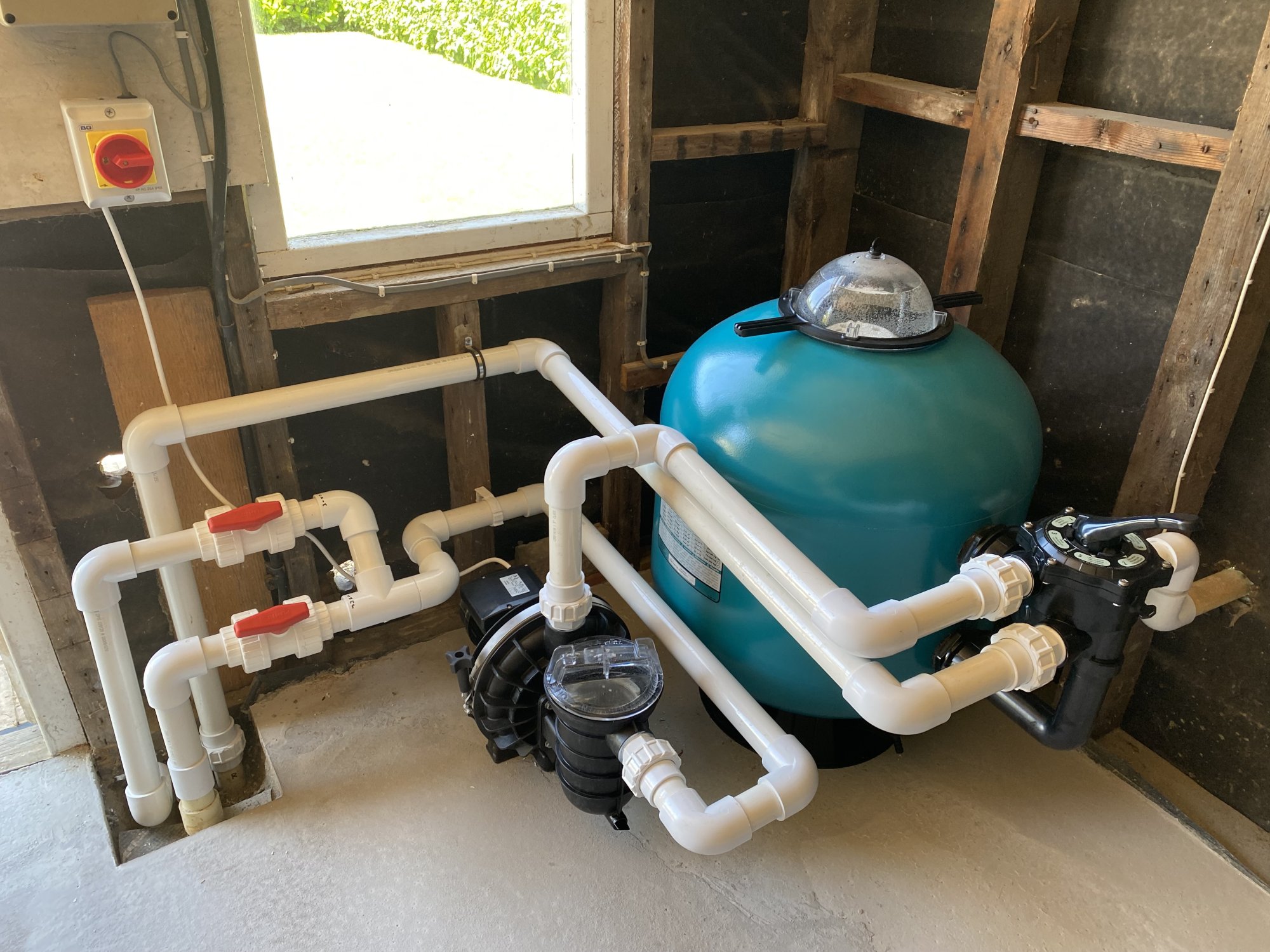

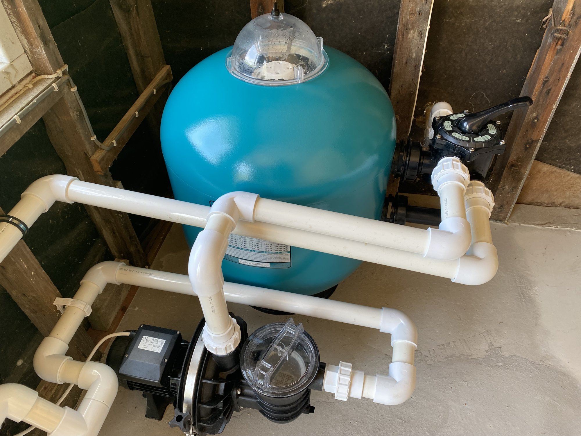

Ah yes, great point. We've been refurbing a very old pool, we put in a new liner and paving etc last year and this year we stripped everything out of the pool equipment shed to rebuild its floor, so the old filter, pump, and pipework alll had to come out.
We decided, given that the old pump's impeller was damaged and bearings shot, and a few other issues, and the old filter was really too
small for the pool and had all its unions covered in repair putty, and fhat both dated from the 1980s, we'd spend the money and replace everything new.
So this guy was here to install and connect up the new pump, filter, multiport etc. Basically everything on the equipment side. His pipework looks neat enough but he was a really weird guy and refused to fit a pressure gauge. He was recommended by a local builder but I wouldn't want him anywhere near the place again.

Lots of people will be afraid of onedrive links so more public links are preferred, but I was able to see it. That’s a different top end than the tr100 in the US. I assume the air bleed valve is open in that video?
The flow looks really slow.
What pump do you have?
What speed is it on?
