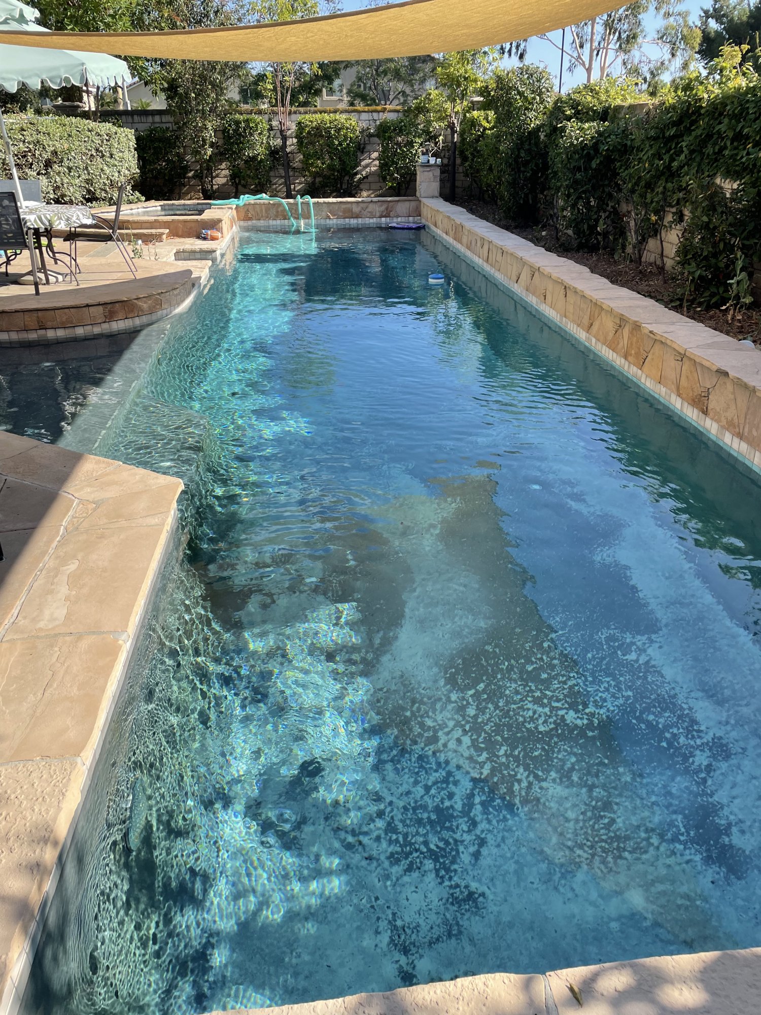

Hi all, I have a pool guy but the service isn't up to par. I regularly get green spots and from just the basic tests I've done the chlorine and PH are never where they are supposed to be. This got me wondering if everything else is out of balance too so I picked up the TF 100 (salt) test kit and I'm ready to take over.
This is my first time testing with this kit so please let me know of any tips or if I need to re-test.

I see a faint tint of green on the swim step.
I don't think my pool guy used copper.
This looks like copper stains.
Try the stain ID kit.

Unless those are very odd reflections, I agree with JamesW there is staining. If this is wished to be addressed, getting a stain kit now would be relevant as if a treatment to remove stains is done, the pool will need to be completely drained.
If staining is not a concern, then a large water exchange or RO is warranted. Up to the OP.
