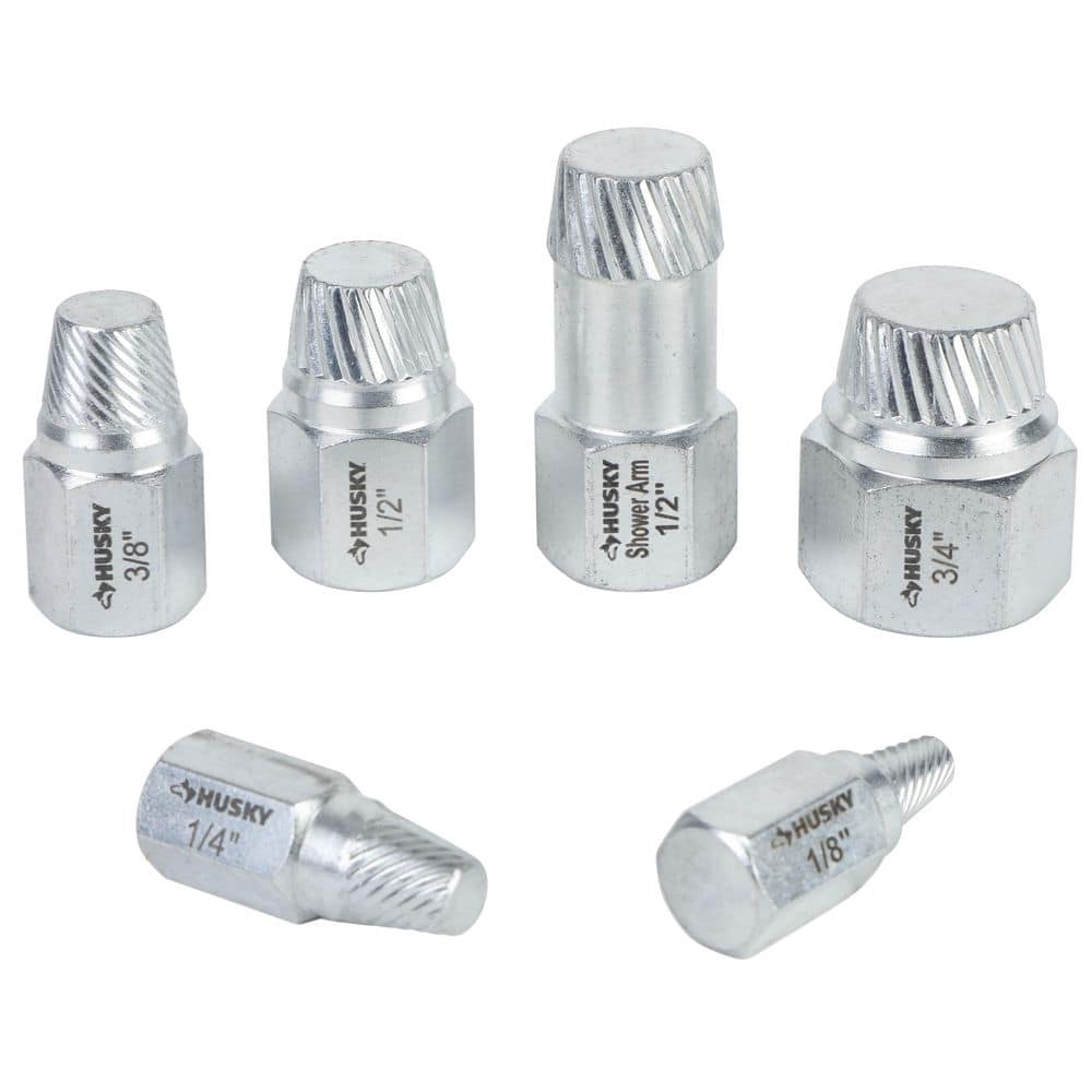

Something like this should work.
If the handle is too long, then this...
Maybe an "easy out" or screw extractor type of tool or a pipe nipple extractor? Find one that fits snuggly into the old broken part you already removed. Then carefully insert into the stuck fitting and carefully unscrew it.
Thank you!!!! I bought these and it crumbled it’s way out !
