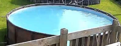

Hoping for some advice to get our pool up and running ASAP! It was very green and is now very cloudy but has been for about a week and had felt stuck till I landed here this morning :).
Fair warning I started off the season using pool store / HTC product advice so roast away :ROFLMAO: :rolleyes::oops:
We have an 18' 6000 gal Round Coleman pool and I just switched it out to a Hayward 1HP Pump with Sand Filter this season.
This is what I started with about a week ago:
This is where I am at now:
Obviously a marked improvement but not clear at the very least.
I am going to read / follow every guide I can on this site but am hoping for some quick guidance to make sure I am moving in the right direction.

Although the pic doesn't look I feel like the water is starting to finally clear. I hope at least haha. Test kit should arrive Wednesday.
Guess I will keep backwashing and brushing and hoping for the best :)

It actually looks worse now then it has but I've also had to backwash my filter twice already so I'm guessing it's doing something 😅
Keeping my FC level up at 24 as best I can so time will tell
SLAM is going good!
