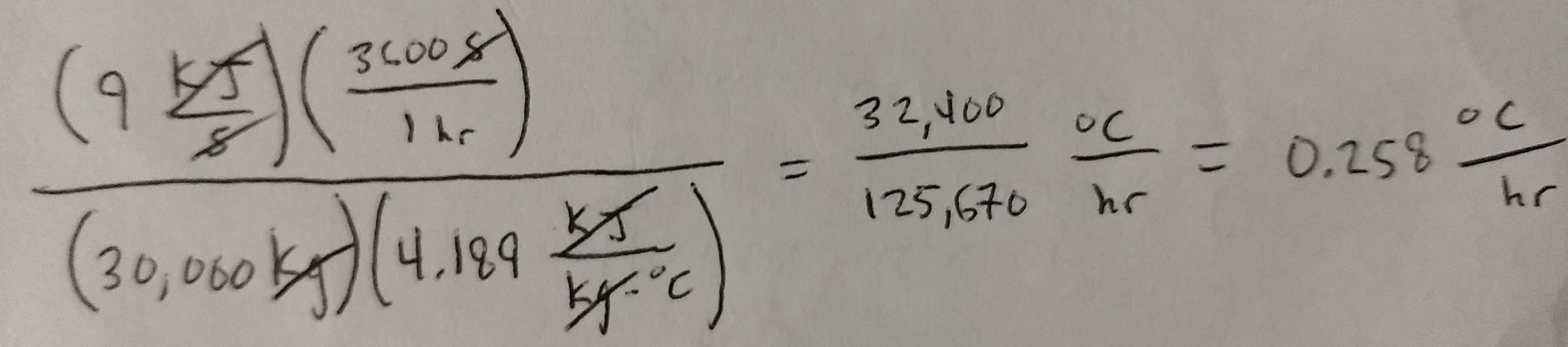

Sure. All numbers are rounded. Also I switch around a bit from metric to imperial, so there might be easier ways to do it.
1 KW equals 3412 BTU/hr. So 9 KW equals about 31,000 BTU/hr. 1 BTU raises the temperature of 1 pound of water 0.56 degree C. 30,000 liters weighs roughly 66,000 pounds.
So 31,000 divided by 66,000 = 0.47. That's how much 9 KW increases the temperature of a 30k liter pool in degrees F. Multiply by 0.56 to get degrees C = 0.26. So I rounded it to 0.25 to easily calculate run time estimates.
Yes, I'm quite certain there is probably an easier way to do it. But then there would be less math, and what fun would that be? ?
If you want to do this all in SI (metric) units and noting that:
  • Specific heat of water is 4.189 kJ/kg*°C
  • 1 L of water = 1 kg (so 30,000 L = 30,000 kg of water
  • 1 kW = 1 kJ/s (so 9 kW = 9 kJ/s)
  • 1 hr = 3600 seconds
Then you have:
which is the same result as @Donldson, without going into imperial units.
If you want a faster number for your pool to size different heaters, then since I've already worked out the units for a 30,000 L pool just take the heater input in kW and multiply that by 0.0286 to get °C rise per hour. So for example if you had a heater twice as big at 18 kW, then 18*0.0286 = 0.515 °C/hr.
