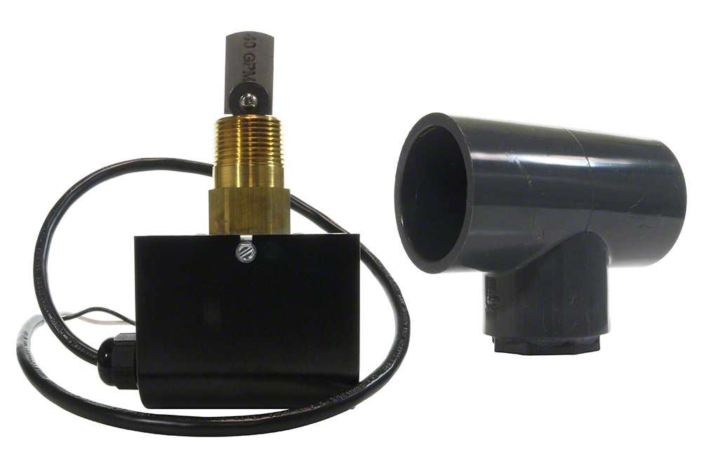

You should install a flow switch to replace the pressure switch...

To be safe you can still install a Heater Flow Switch - Further Reading
Even with a check valve, there will be enough pressure to close the pressure switch.
Basically, if the pump is on, the pressure switch will close regardless of the valve types or configuration.
With a bypass, the only way to be safe is to add a flow switch.
@JamesW Do you have a reference to install a flow switch into a non-salt water Aqualink? Basically, trying to figure out the wiring into the control panel so that it shuts off the heater when no flow is detected.
The heater flow switch connects in series with the pressure switch in the heater, and does not make any connin the Aqualink.
