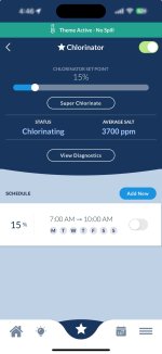

I purchased a second hand Hayward T-Cell 15 on Ebay. SWG seems to be producing chlorine, I tested in a bucket with my current pool water and noticed a good amount of chlorine emitting from the device. The question I have is as follows:
* SWG is connected to Hayward OmniLogic
* I have set the unit to only produce 15% of the run time. The pump runs about 8 to 10 hours per day.
* Even at 15% chlorination set point I notice that the Status always shows Chlorinating.
* When I view the Diagnostics Relay Polarity alternates from K1, to K2 to OFF.
These are my current reading from SWG as of this writing.
Cell Temp: 57.9 degrees
Average Salt: 3700 ppm
Cell Type: T-CELL-15
Cell Voltage: 28.29 V
Instant Salt: 3525 ppm
Cell Current: 6.86 A
Relay Polarity: K1
Question: Given that I have set the 15% chlorination setpoint, shouldn't the unit turn off once it reaches the 15% coverage and Status to ON instead of Chlorinating? I could have sworn I had seen this behavior a while back but now it seems to always show Chlorinating.
I tested my water and my Free Chlorine is showing 24.12 and total Chlorine 27.77 ( which is quite high ) which is indiactive that SWG keeps pumping chlorine into the pool?
Many thanks for the help.
