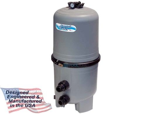

A 37.5sq. ft. DE filter on a pool that size? Go this way for the same money and never look back:

I had that same filter. The EC65A. I I had a few broken finger tubes. Maybe a dozen. A whole new finger assembly was around $800.00 last year. It sounds like that's what they're telling you you need. I said no and went the same way 1poolman1 suggests. Mine is a size larger though. Love it. Clean it once a year and other than that I don't think about it. It's very nice not having to deal with DE anymore and forget those 17 bolts that hold the top on the EC65. I'd have gotten rid of it just for that.
