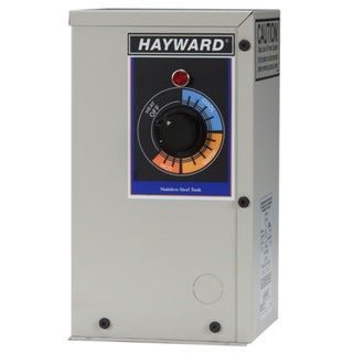

I've got a working CSPA I'd like to add a switch to, ie an enable type switch. I think I just saw one wired to have an external switch, but like a dummy I just forgot to take a picture.
The external switch of course could be a timer or automation control line, but for now it will just be an external on/off switch.
The unit is currently the boring manual set the temp, and turn completely counter clockwise to turn it totally off.
Can any show me a diagram and or picture?
