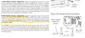

I am hoping someone can help me. I have done a number of repairs of my system, as of late. One of those was fixing the dreaded CE error which I managed to fix with a new keypad and board for the heater. The issue I am having is that before replacing the board in the heater, I could leave the heater in bypass and when I hit spa or pool on my remote and turned on the heater, it would flip the heater to spa or pool heat mode.
After replacing the board it doesn’t seem to matter whether I push pool or spa on the remote it always jumps the heater to the pool heat temp setting. I can manually flip the heater to spa mode and it takes it to spa temperature with no issue.
One other small issue, the heater is saying it is heating to 104, but the spa isn’t that hot. I replaced the heat exchanger a couple of weeks back, could that have anything to do with it?
