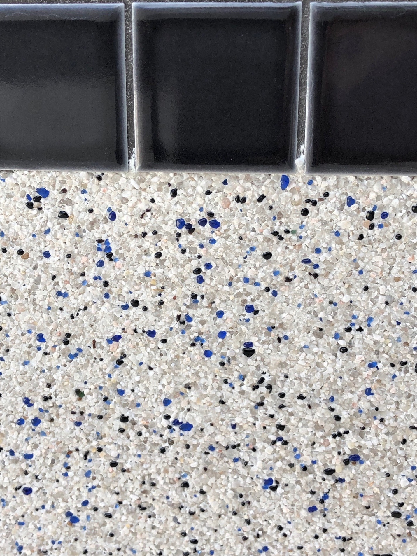

This is a close up of the pebblecrete surface. The cured cement has minimal exposed surface area but I guess the problem with overdoing acid treatments is loss of cement and pebbles falling off.
Can you feel it? Does that area feel different at all?
You are correct in the acid treatments being tough on the plaster. The acid removes some of the plaster.

Thanks Kim and that’s a good point that I did think of. The surface is not raised, smooth like the rest of the pool. But from a close up perspective I don’t know if this staining is confined to the plaster or covers the pebbles as well. I’m thinking that it would be confined to the cement ‘grout‘ between the pebbles.
