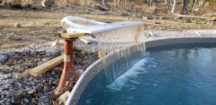

  2. My wife decided the 4' sheer descent waterfall was too narrow, so now considering doing something like this since is has a much lower GPM requirement...
    1621347402806.png... anyone have any experience with them who could tell me how they look/sound?

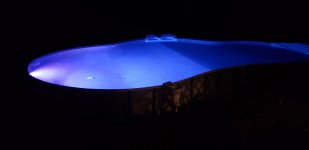

  4. I've got a pool that looks like the moon... more to come on that in a moment.
So, here is what we see when we turn the pool light on at night...
I completely understand that some settling or depressions can happen around vinyl liner pools. However, this just seems totally outside what could be considered normal. Aside from the fact we never want to turn our light on again because it looks like some alien landscape, I'm rather concerned about one particularly large depression. The pictures don't quite do it justice since there is no sense of depth, but the thing looks to be about a foot across, a couple inches deep, and sided by rocks. Here is a top-down pic of it...
I'm concerned this is just going to cause the liner to fail.
Thoughts? I'm waiting on the installer to call me back, but I'm 99.99% positive he is just going to say "settling is normal, it's just aesthetic, nothing I can or will do about it."

is it possible you had significant groundwater intrusion? It almost looks like washout. Also, what's the chances that part of the ground froze over the winter and you had heaving?
Ground water is possible. But then again, these idiots back-filled with dirt (against my wishes) and bony dirt at that. I was told over and over by the PB that the spring rains would settle the dirt enough to do my patio this year. It is entirely possible, nay, entirely likely that the rains settled the back-fill but also ran down and caused this problem.
