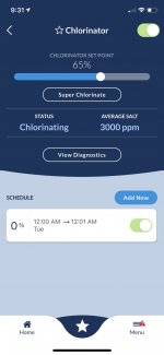

What's next? A little more Stabilizer to get my CYA in the 70s? Should I start tackling TA now? Should I be worried about my inability to gather CH data?
@magiteck - I had planned on doing the Overnight Chlorine Loss Test but forgot to shut the chlorinator off after gathering my pool sample and testing for FC tonight. If you think it's still needed, I'll give it another attempt tomorrow night. While on this topic though, I imagine to shut off my SWG, I just toggle the green switch in the top right corner of my Hayward app to off. See Image. Would you agree? Or set the Chlorinator Set Point to 0%?
Chlorinator Set Point % -- I've never messed with the percentage. What should this be at and why? Does it ever need to be changed?

I’m not familiar with the operation of SWGs so hopefully someone else will chime in on your question RE turning it off.
flip the switch to off... The hayward controllers still run about 5% when the knob is turned to 0..
