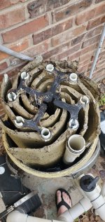

No no, didn't mean moving to a non-DE filter, just meant is there another DE filter I can use that isn't as complicated as this spiral filter that I currently have. I'm attaching a picture of the current filter (before it was cleaned!)
These grids are quite difficult to clean and put back together. The DE filters I've seen online take cylindrical cartridges and seem much easier to clean.

Again, it can be done as the tanks are the same. But, the cost to do so and the work involved are very high. You would need the 4, properly sized DE cartridges (don't know which size would fit your tank, likely Quad 60, +/- $170.00), new everything in the tank (including the air relief tube at about $40.00), along with replacing the bulkhead fittings for best results. The system would need to be re-plumbed to accommodate a new valve or just to plumb direct. You might save your existing valve, but a complete re-plumb of it would be needed to account for the different flow in and out of the filter.
Or buy a new filter.
