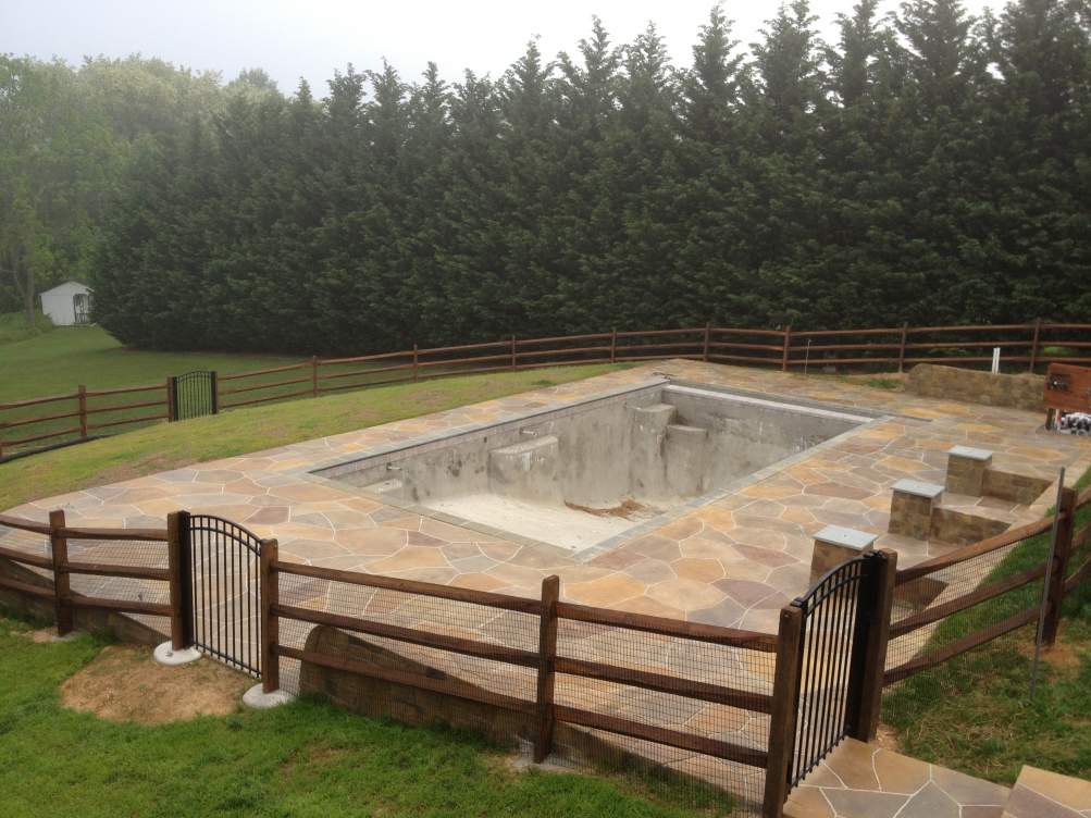

Just for tickles and giggles, here is a picture of my fence which I did myself. Mesh is 1x2 black vinyl coated steel mounted outside. Gates are mounted on their aluminum posts which are in concrete along with the first split rail post. All other posts are in dirt.
