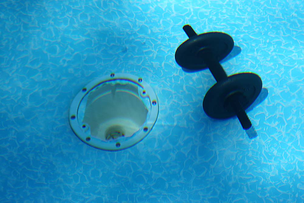

I'm pleasantly surprised how good mine looked. I didn't do anything to the light or drain & just waved my hand around the niche to remove some debris that was in there. The 15lb dumbbell worked well.
