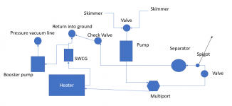

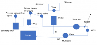

I'm assuming from the video, though really tough to see, that that the line from the SWCG and the line from the separator join and go into the ground. Assuming that, here is what you have.
  1. if the multiport is in "filter," water from the pump goes through the multiport, filter, the to heater, SWCG and back to pool. It also feeds the booster pump for the pressure vacuum.
  2. If the multiport is in the recirculate, it does the same but does not go through the filter.
  3. If the multiport is in Backwash, it will go through multiport and reverse the flow of water in the filter and will push water out the WASTE side of the multiport. This will take all the DE out of your filter and put it into the separator. If you backwash, you want to make sure the T handle is open.
  4. If the multiport is in rinse, it will push water through the filter in the normal direction for the filter, but water will go to the WASTE side of the mulitport. If you rinse, you should have T handle open.
  5. if the multiport is the WASTE position, anything pumped will go through the multiport, but NOT through the filter and will go to the WASTE side of the multiport. You should have T handle open.
  6. For Backwash, Rinse and Waste, all water will be returned to the pool. The separator is used if you backwash to catch any of the DE and particulates from the backwash.
  7. The ONLY way to use this system to drain water from the pool is by using the spigot.
    1. Since the pad is below the pool, you can use this to drain without pump running (as you found out). Open T, open spigot.
    2. You can turn on the pump with Multiport in WASTE, T handle open and use spigot open to speed the draining. As you found out, you need to close the valve on top of the separator. Under pressure it should NOT spray water like it did. If you can manually close it so it doesn't spray, you are good to go. If it sprays AFTER you manually close, the o-ring is likely shot. You can try to find a replacement at HD/Lowes/Ace if you have the old one. If not the vent valve, with o-ring is Hayward part #ECX1322A.
Net Net is that the waste line goes back to the pool (if, as I said, the SWCG line and Separator line join and go into the ground.
That should give you summary on the equipment and how it generally works. Valve from skimmers (or from skimmer and main drain if that is configuration) will allow you to control how much comes from either one, or allow you to close one, the other or both. It is likely setup so that you can only close one side if the pins are in the handle.
Hope this covers the equipment end of the equation, and how to drain.
