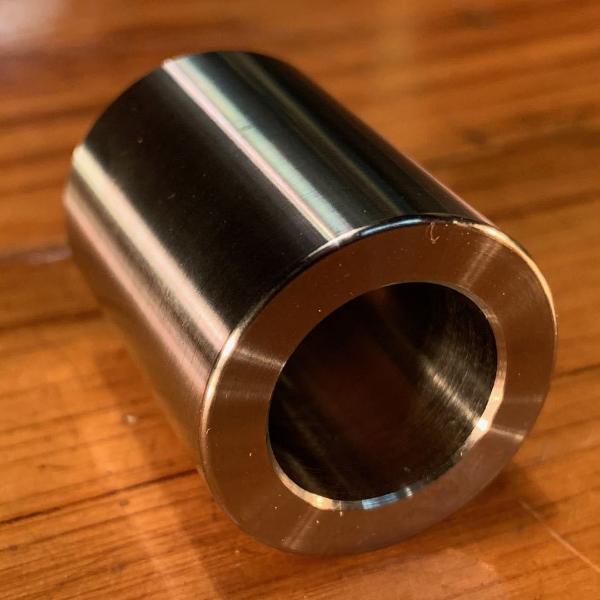

If you had a spacer before, you need a spacer now.
You want a 1" long, schedule 40 Stainless Steel (preferably 316 SS), 5/8"ID / 7/8" OD spacer, 1" long.
Did a quick search and that is a very specialty items with no direct sources I could find, at least for 316.
Here is one solution, but is 304. Not sure the service it would provide, but would likely work.
Reactions: KyleMontana
