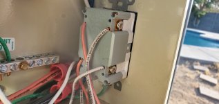

Any electricians, I'm trying to power my automation from an existing GFCI circuit in my pool sub-panel. Does this look like it will give GFCI protection to the automation? I suspect my neutral wiring might be wrong. It could all be wrong. Please excuse my ms-paint skills.wring.jpg
I'm starting to think my neutral wire needs to come from the load side of the GFCI. Can I just stab another wire into the back of the GFCI outlet on the load/neutral to run the neutral to my automation, or wrap around the screw, or is it better to splice it in with a wire nut? Am I missing something the coroner will have to explain later? ☠️
You definitely need the neutral for all of the protected equipment to come from the load side of the GFCI, otherwise it will (should) trip as designed, so your second diagram is correct.
You can use both backstab holes, but you have some other issues there -- my understanding is that most backstab connections are not rated for stranded wire like are in there already. That loose strand sticking out is one reason. And I suspect the way that dual switch sits in the slot intended for a decora switch leaving a gap isn't right either.
One option would be to attach a short pigtail length wire to the outlet (solid to either screw or backstab, stranded to screw), and then a wire nut at the other end to splice to the multiple wires. I am not an electriician -- verify this against other sources or consider hiring one to do the connections.
Reactions: strategy400
Yes, and the "pros" that built the pool wired the panel. So the stranded wire and suspect switch is their doing. I also noticed they wrapped a wire counterclockwise around a terminal screw. I haven't died yet.
I stabbed a solid wire in next to the stranded for neutral. They both feel firmly anchored in the terminal. I may do the pigtail later. My load is coming off the switch. I also ran a ground from the panel ground bar to the ground in my automation, which is just a din mounted outlet. None of the components in the automation box even use a ground. If I go silent on the forum please donate to TFP in lieu of flowers.
