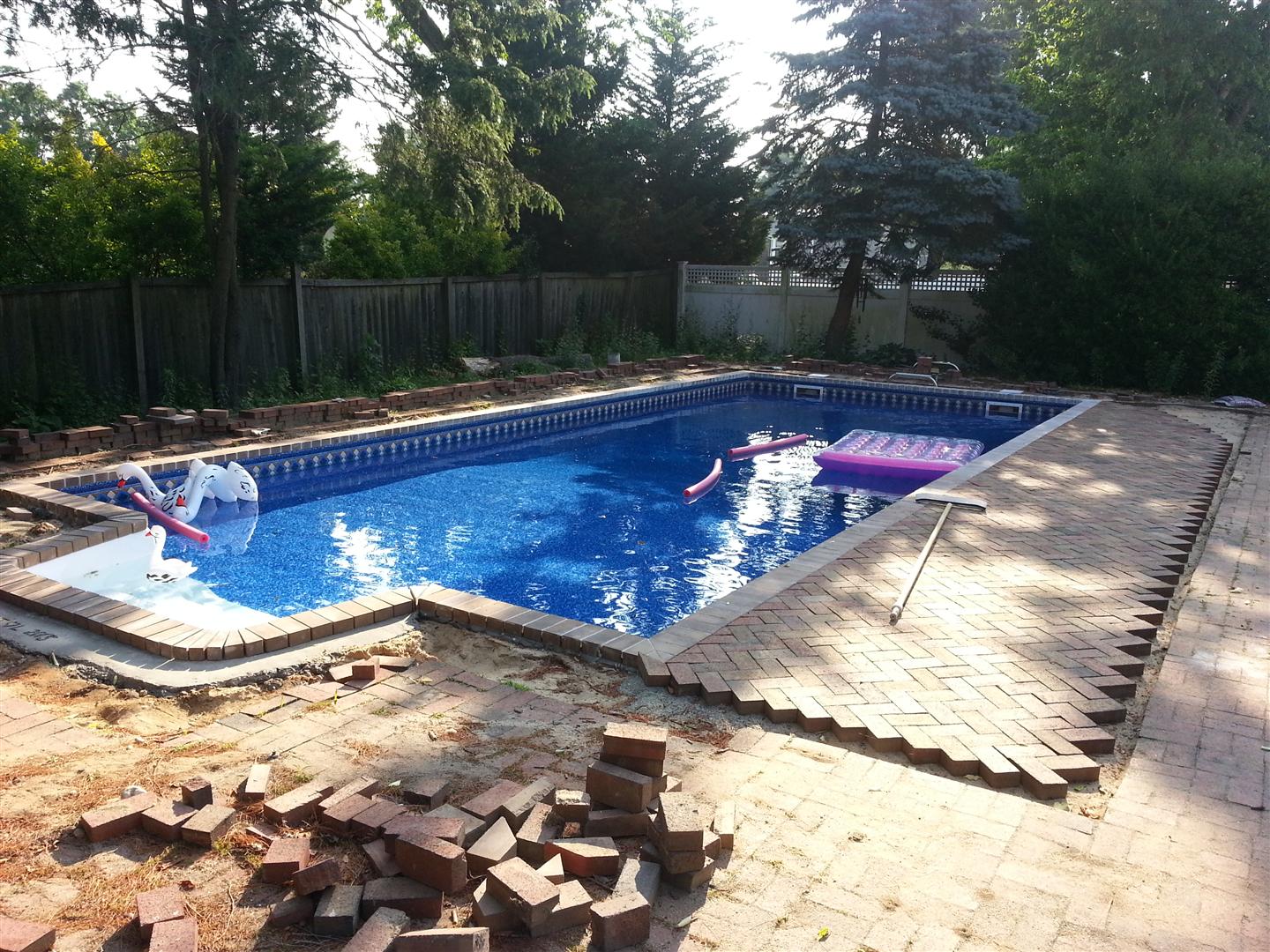

Now a week later, the pool is not losing any water at all. I know I have a couple of drips at the filter, but otherwise everything nice and sealed up.
We started pulling up the existing pavers, cleaning off the moss, and re-setting them in a new herringbone pattern. This requires an awful lot of cuts. Its a lot of hard labor, and it goes MUCH slower than I thought it would. I did install teh outdoor speakers over the weekend in order to make the repetitive task a little less painful.
After using up 15 bags of store bought sand to regrade roughly 100 sq ft, I just ordered three more yards of sand to re-set the pavers in. The side shown above isn't so bad, but the other sides are much lower than the coping. Ill build it up against the pool coping, but keep the grade sloping away gently.
