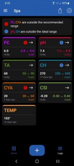

I'd like to eliminate the 1ppm CC that I've had in my spa for the last few weeks. Disabling the ozone system a few weeks ago helped reduce the FC burn off, but also seems to have eliminated the ability to oxidize the CC.
Yesterday, I hooked the ozone system back up and put it on a switch so I can turn it on or off as desired. 24 hours later and I'm still getting the same 1ppm as yesterday. Is this a process that will take some time? I'm adding LC to keep FC from going to zero. From what I've read it seems that the ozone system should be able to remove the CC but I guess I'm not sure if there's anything else I need to do.
