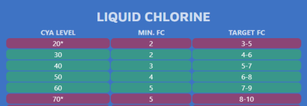

The chlorine levels have always been fine, and a test the other day showed chlorine still at 4ppm, which isn't all that high but should be sufficient. Because chlorine levels have always been good, I don't think a SLAM is needed or will do anything.
