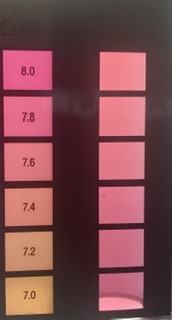

I can relate to the CCL pH test being hard to read. Their comparator truly sucks. Having ordered a Taylor comparator from the US was a revelation. I'm still using mainly my meter, but the drop test is now at least an option.

Unfortunately these multi parameter meters are a dime a dozen, on ebay, Amazon etc. Without calibration they are really just a random number generator. Unfortunately you would have been better off investing your money on the smart stir and an Aussie gold kit for a pH comparator upgrade.
I stuggled with the pH test but a few tricks can help big time. Take a photo of the comparator and edit out everything but the sample and comparison windows and then choose the best match from the photo. Another good idea is blank white card in front of the comparator with a small rectangle cutout to isolate just one comparison window and sample. Move it up and down to select the best match.
