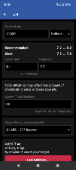

I was adjusting my pH normally, but noticed something weird the approximate effects of muriatic acid on PH on two different place in the app seem to vary.
In order to lower pH by 0.4 i get two different recommendations 6.7 vs 18, that's not even close, is this a "bug" or is there a difference in calculation between these two? And if so can it explain the high gap.
In pH screen I get recommendation for 6.7 oz :

Hey Mark and Welcome !!!!
The first screenshot is more accurate as it's factoring your exact TA (60), versus a ballpark TA of 80 to 120 in the second screenshot. Also note the 2nd and 3rd note on the bottom of screenshot #2. Your 8.1 is out of range for the 7.2-7.8 that claims moderate accuracy.
