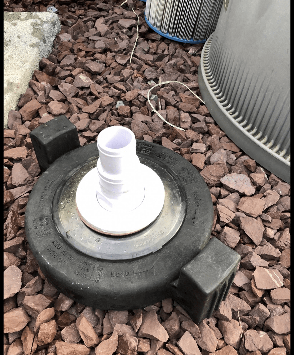

All my skimmers and returns have unions on them for winterizing so I made a fitting to mate with those unions. 1.5” PVC and I think I used a short section of pool vacuum hose to connect them. image.jpg
All my skimmers and returns have unions on them for winterizing so I made a fitting to mate with those unions. 1.5” PVC and I think I used a short section of pool vacuum hose to connect them. View attachment 524745
Thanks Bperry, that's what I made up for blowing out pipes, thanks for the confidence boost, but for the Paramount in-floor cleaning system I am making a connection for the blow out plugs that will connect to the cyclone with these from amazon.

Hi and thank you, can you identify/name the connector in the picture please.
