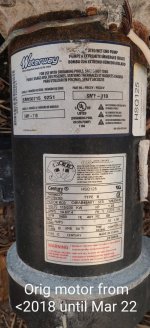

Found the old motor photos and it was also THP 1.25
So to recap, bought the house in 2018, with an oem waterway/century 1.25 motor, which began to overheat last March 2022, so motor was repl with the exact Century HSQ-125 motor, which then got flooded in Sept 2022 but still ran with bad bearings until last week, when I bought another exact Century HSQ-125 to repl bad motor (def caused by hurricane flooding)
Never had/needed any other pump work during last 5yrs. Never any leaks or other probs (besides suction side leak which is a whole other problem). Have a Hayward Star Clear Plus filter with PA-90 cartridges.
So I'm still not sure which repl impeller to buy, I get stuck on the THP being my motor is an odd 1.25 - since everything pump-wise was working fine for last 5+yrs using same thp 1.25 motor.

And now I see the SMF-110 on the orig motor label, so that answers that. Thanks!
