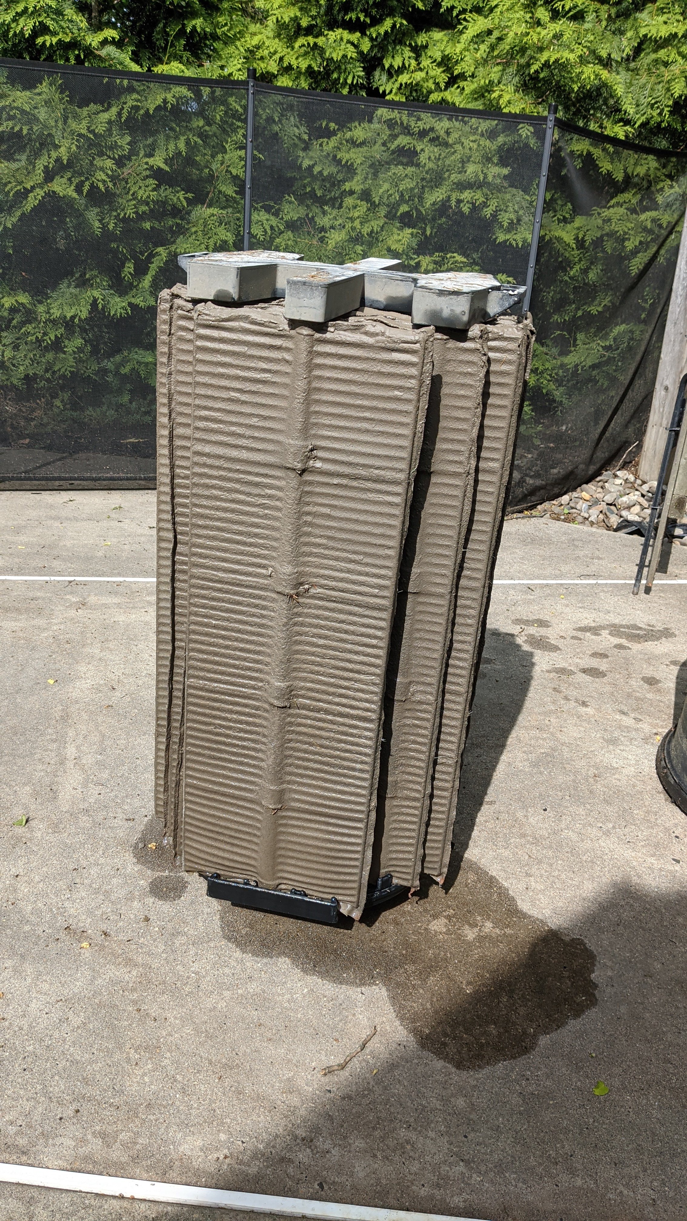

This year it taking very long time to get the water to get super clear. I have dumped tons of liquid chlorine to get the water clear. I still have to get the test done for the day but I know there is lot of chlorine in the water. I have a DE filter with ripped lining in the Grid. Maybe two or three grids have edges where the stitching came off. Majority of the DE I add from the skimmer gets pushed back out from the return lines in to the pool. Grids are not holding the DE. Can not having DE in the filter cause cloudy water? Should I replace the Grids or jut get a new Filter?
I went through this several times over the years. What I finally wound up doing is to buy a new complete assembly (mine holds 10 grids in all) so that I always have one on hand while the other is being acid-cleaned. I've also just replaced grids. Mine have round plastic spacers in between each, so when reassembling the whole thing have to really watch that the edges of the grid material wind up under those spacers so as not to leak DE (or other dirt, etc.)right back into the return lines. Weird taking the whole thing apart since it's sort of like dominoes until they all get lined up and then there's a long threaded shaft that runs through the middle of the assy with nuts on both ends. Really a 2-person job otherwise it's almost impossible to work from both ends at the same time. If the whole thing isn't tight enough, there can also be leakage (not to mention that the grids tend to shift position when lifted out of the filter tank). I'd buy new grids - makes a big difference.
I'll try to grab some pics of the grids inside the filter.
Be curious to see what yours look like.
