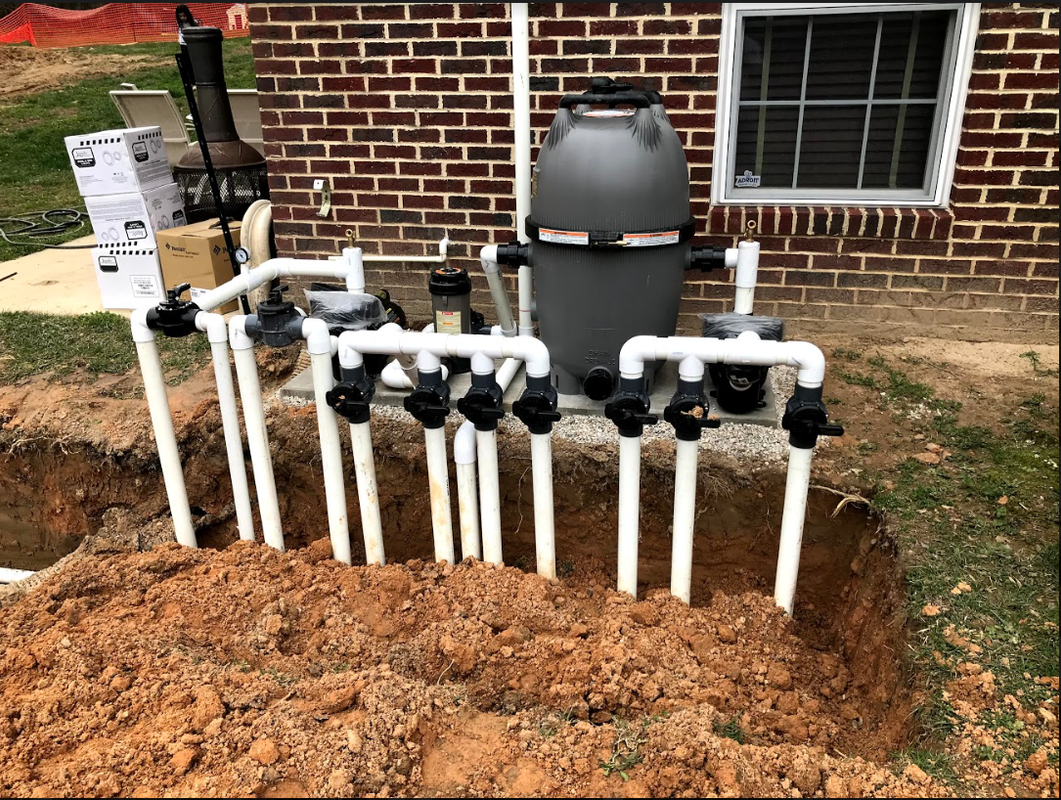

Here is a picture of my equipment pad. The right hand side is the filter pump where the check valve is, on the line leading right into the pump from the pool. The left hand pump is for the waterfall.
