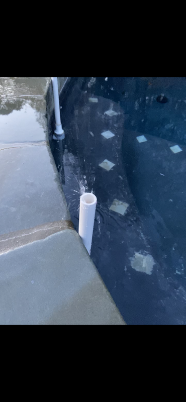

Good news using the tips provided in this thread. I was able to fab up some “snorkels” that cost way too much and took way too long to assemble the parts list at Lowe’s but I am confident that I was able to remove all but a non-harmful amount of water. With the help of my 4 year old son and turning the air blower and Cyclone on and off repeatedly, I was able to blow out nearly all of the water. I am leaving the “snorkels” capped for a few days to make sure the Teflon-taped PVC threads are water tight and then I will pour in some antifreeze and call it good.
I had a hard time with the “snorkel” parts because I wanted to be able to reuse them so this meant I needed a few threaded parts so that I could tighten the elbow into the pool wall. I had planned to have the top of the “snorkels” above the coping but due to variances in the stone size and pool wall, I did have to cut a couple of them down to below the coping so I could screw in the vertical pipe. I am satisfied so far and this will go soooooo much quicker next year.
I will say this—I don’t know how I would’ve done this without the Cyclone and hose fitting in the top of my pool pump cover. I tried avoiding both of those and cost myself many, many hours of frustration. Lesson learned.
Here’s a shot of a couple of “snorkels” in action while I was still clearing water. I’ll get some better pics of the whole assembly soon.

Nice job Captain. The first year is the hardest figuring out what works on your setup. You may re-engineer something in a few years, but it will be for fun, not necessity.

Please be careful of those snorkels, ice can and will move or break them off.
Interesting. Have you seen this happen? I did use schedule 40 PVC thinking it would be fine as long as there wasn’t water inside of the pipes. I figured there would be enough room for the pool water to expand if it did freeze.
Pool_Medic
In The Industry
Apr 1, 2018
1,197
Bangor Maine
No, I haven’t seen it happen because I’ve never in my years seen a pool in freezing areas with a pool closed this way. It’s not the expansion that’s the concern, it’s the ice shifting with the winds before or after that huge ice cube has frozen itself to the walls.
Newdude
Jun 16, 2019
3,680
NY
Nice catch PM. the ice block melts from the sides first and then free floats until it fully melts. Even if it only shifted an inch that is a lot of force on the snorkels and returns.
