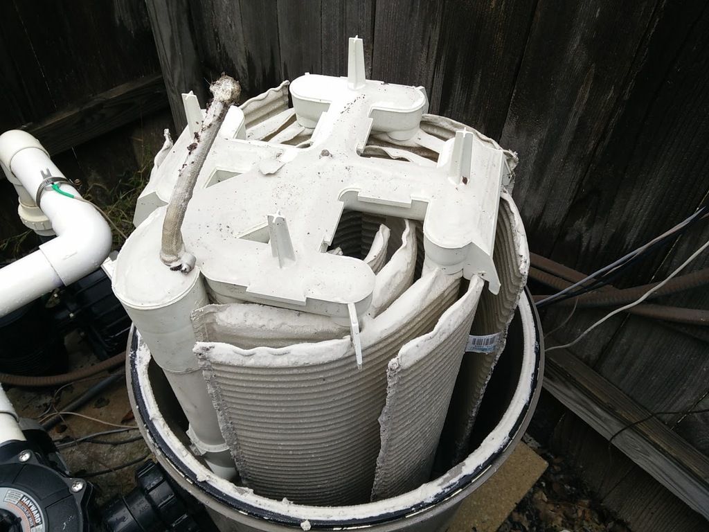

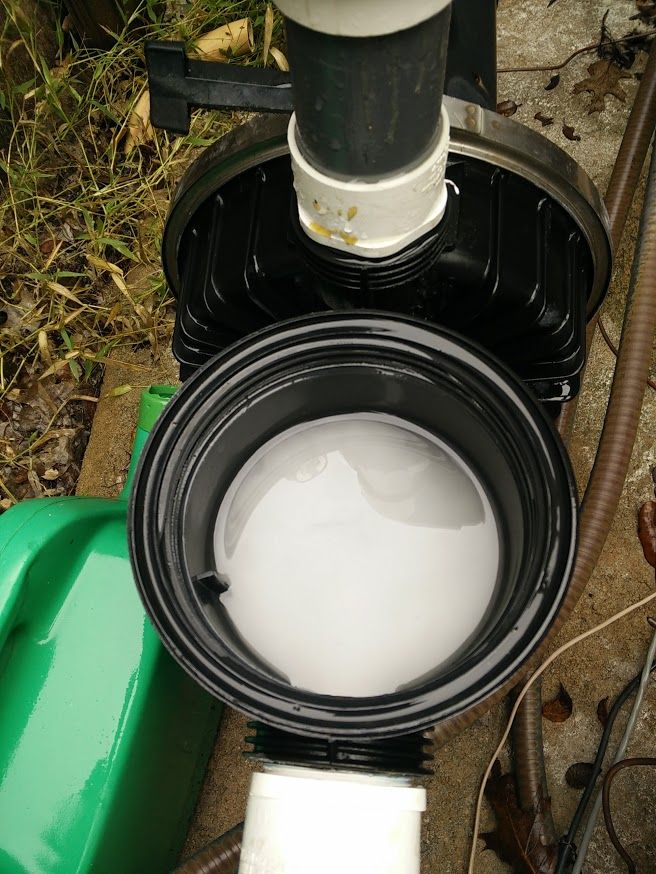

Is the filter ok? Is it normal to see DE all over the top like that?

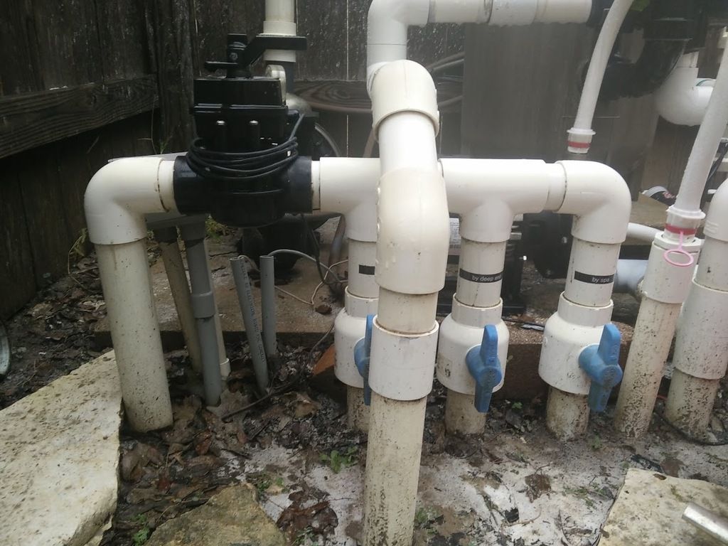

Yes, that's what the DE looks like...although there is a lot of it in there now. But your filter should be fine. Let me see if I get your picture right - there are three pipes coming up out of the ground on the POOL side of the suction line and each pipe has it's own shut-off valve. Is that correct?

I took out the filter and noticed 2 things.
1. The DE was only on the top of the filter and not really anywhere else. I've hosed it down.
2.The bottom of the filter housing was completely covered in a DE slurry. The drainage for the filter was blocked. I took handfuls of it and it has half-filled a bucket. I've hosed down the filter housing so that it is now clear.
Was any of that normal?
"there are three pipes coming up out of the ground on the POOL side of the suction line and each pipe has it's own shut-off valve. Is that correct?"
yes, that's correct.

What you report sounds normal. I'm not as familiar with the Hayward filters but it is the case that DE, especially fresh DE, can build up in the bottom of the tank. My Pentair filter is designed so that the input water into the filter body is directed downward so as to agitate any DE slurry.

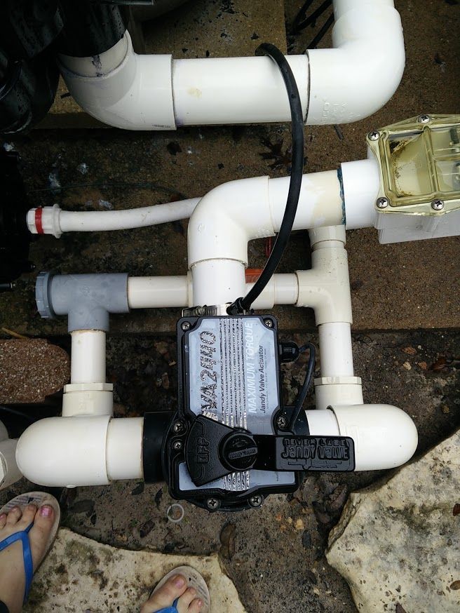

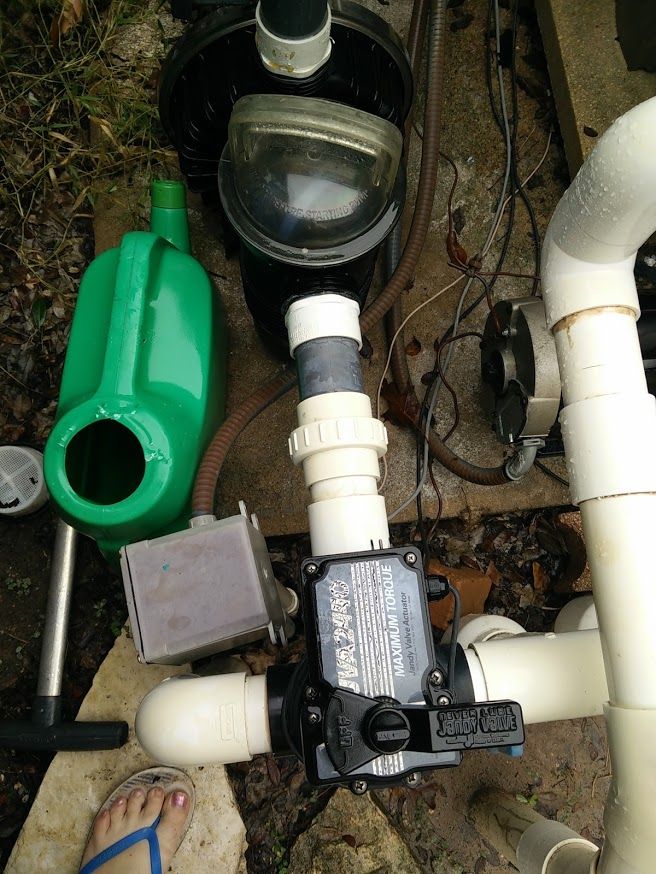

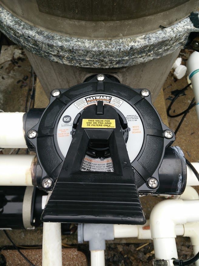

I've taken a photograph of the 3 pipes coming from the 2 pool skimmers and the waste and it shows the 4th intake which is the spa. Here's why I wonder about the suction side blockage. Since the pump is not taking water from either the spa or the pool ( I can isolate the two), then surely if there is a blockage then it is after the jandy actuator and valve? ie. in that 10 inches of pipe between the jandy valve and the inlet into the pump basket?
Here is the photo showing the 4 pipes and the valve. The spa is the pipe on the far left in the photo
I have investigated the impeller as much as I can, is there anyway to check that out without actually taking things apart?

Tomorrow I will attempt to take off the actuator valve and try the drain king from there. Maybe it's the valve that's clogged? Or maybe that is leaking?
Always worth a shot looking into the valves. I wonder, is your multiport valve set correctly and, if it's not too much trouble, maybe you should open up the multiport valve and see if there's any blockage in there.

I gave in and called my almost ex-husband to ask if he had any ideas or could help me. You have no idea how much pride I had to swallow to do that. He said to make sure the impeller was clear - and to use one of the metal tent pegs to really get in there. I said I had already used something else and it seemed fine. BUT I went back with a tent peg and there was indeed a blockage that I hadn't been able to feel before. Water is now flowing well.

It sounds like this is a recurring issue since your ex knew what to do. I suspect that the basket is floating up at times allowing debris to get around the basket. Put a medium sized rock in the basket to keep it from floating up.
Normally, that basket has a handle that loops up and touches the lid, which keeps the basket down. The handle is missing, so the basket is likely to float.
