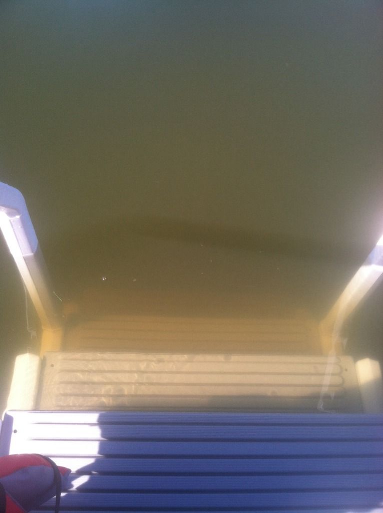

Could you please post a picture of the pool? Preferably looking over stairs during day light hours. If you take the same picture in the same lighting conditions you could compare and see if you're making progress. From my reading on the subject it seems there's no easy way to remove iron out of the water. You can temporary dissolve it creating impression it disappeared but in reality it will remain and eventually fall out again. So from this point of view brown water is better as it allows iron to be actually removed by filtering it out.

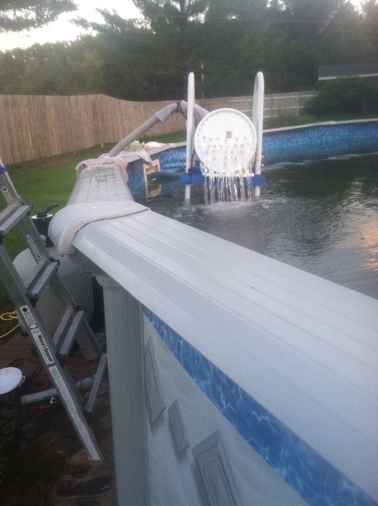

So I start the towels, hubs isn't home to fabricate a contraption so I start stuffing brand new hand towels in the skimmer. I can fit 3 w/o Interupting flow

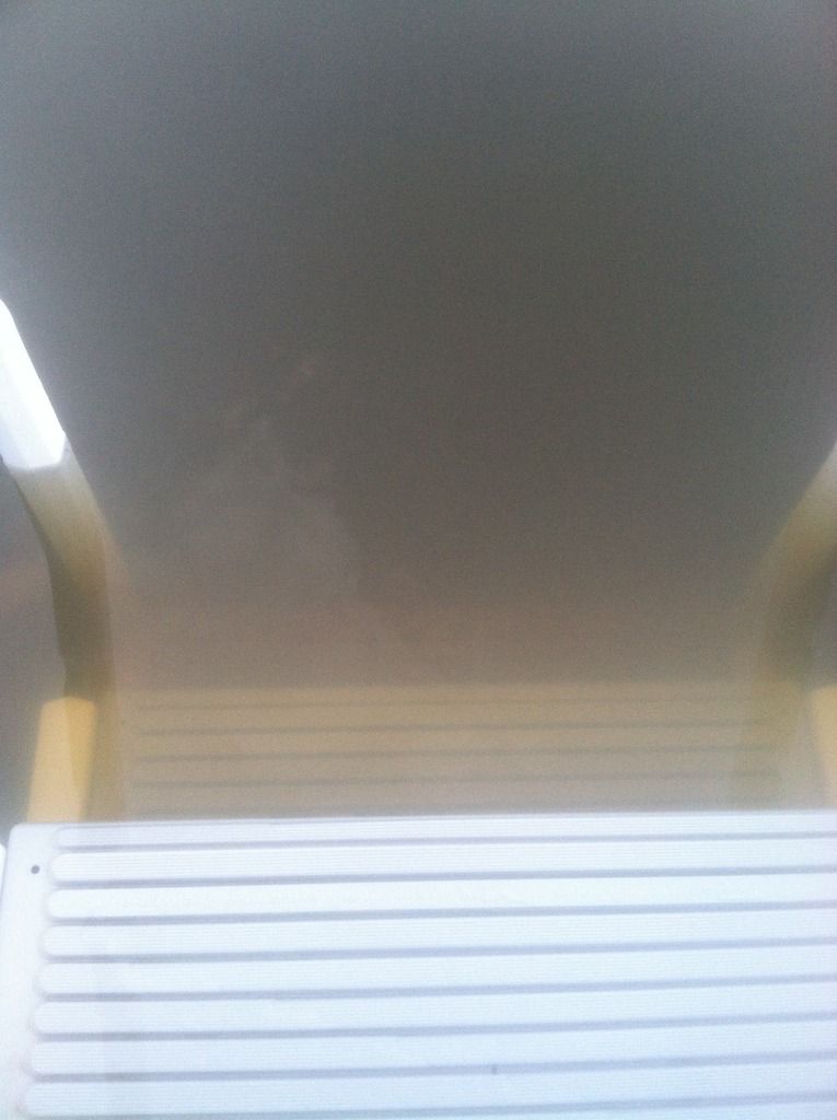

If you needed a comparison:
Sunday: 7/31/16
Today:
Sorry the last one isn't directly above the stairs, I couldn't get my 3yr old to move.
Tada!
