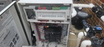

Where are you seeing this? They still sell the different Aqualink setups at Jandy so not sure how that would work. Does the kit include the new RS PCB board? The picture shows everything but the smaller PCB board that has the feature set on it.
It almost looks like it doesn't include the feature set PCB and they expect you to use your existing PCB. It also needs the correct "shared/single/dual" feature set.
