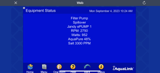

So the automated valves moved correctly. On the suction side, it did NOT move and only have suction from the pool. (EDIT - this correct as it should not move - you want suction from the pool in SPILLOVER mode.) On the return side, the valve moved correctly from return to pool to ONLY to return to spa. So there should be water flow coming from the jets. Did you feel the flow? Therefore the water in the spa will rise and overflow the spa back into the pool.

The iAquaLink screen you show indicates 2750rpm when in SPILLOVER mode. That should generate pretty good flow for the overflow into the pool.
