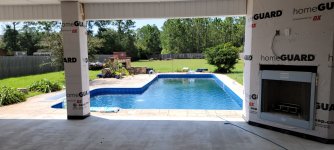

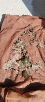

Thats about 450 maybe 500lbs of sand. And James is right that looks like the wrong sand. It looks like play sand. I hate those top mount filters. Make sure that is the same color sand in your filter. Scoop some sand out of the filter and compare the two.
If that sand is on the steps it sounds like its not blowing from your jets. I know James said that already. Screen some jets to find out.
I see your home is under some kind of constuction
We drained a pool once and repaved the deck. We refilled the pool but had sand blow back for months. Nothing wrong with the filter. Turns out some sand and dirt washed down the drain pipe from the deck then hardend, and blew small amounts of sand into the pool.
Also dont ask me how but when construction pops up across the street, I get lots of dirt and sometimes sand in a pool from the wind.
