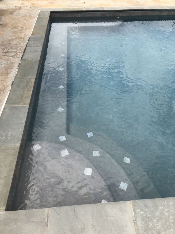

My step marker tiles are 3x3 cutouts from the 6x6 waterline tile. I agree with the above that you will see some chips depending on a variety of factors I suppose. They look fine, but if you look closely you can see them. But honestly, you'd only see the marks with still water. Any movement from your pump or people, and it looks perfect. If there is a large difference in color between the tiles and the plaster, you will see the imperfections more.
