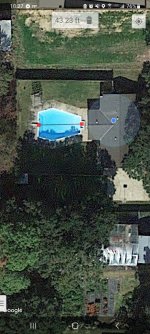

That’s a huge pool. Got any pictures?
How sure are you of the gallons? Mine is 27k and doesn’t look much smaller than yours.
Pictures don't do it justice. It's 33ft wide at the widest point and 42ft long. 10 foot deep on over a quarter of the pool. The gallons came from the company that replaced the liner. It's 1,482 Sq ft of vinyl.
Mine is 14.5 feet wide by 40 feet long and only goes to 8 foot depth and is 25K gallons. The picture is deceiving. Using the robot as a reference I can see it being 33 x 42. 72K gallons seems in the ball park!
Yeah it's too big in my opinion. Came with the house and got it for a good deal so the wife wouldn't let me pass it up lol. Here are some Google map pics for scale. The house is just a hair over 1900 Sq ft.
