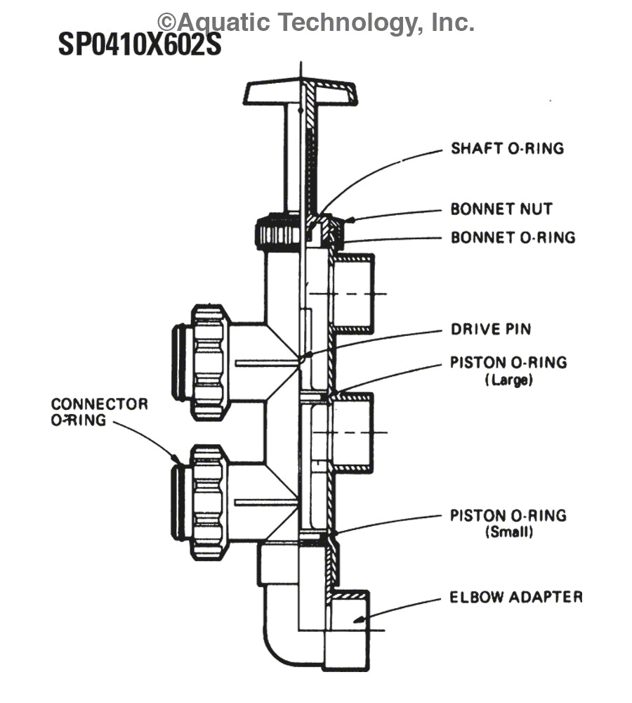

If you are hoping to simply resolve a small leak between the filter body and slide valve nut fitting, yes, there is an O-ring between the two. Below is an example illustration with parts breakdown. You could try to replace that O-ring. A couple other things to consider. If the slide valve is old, you might consider ordering an entire rebuild kit for it since the O-rings in the slide valve may also need to be replaced.
Another thought is changing from a slide valve to a multiport valve so that you'll have more options (recirculate, waste, etc). You have options. Hope that helps.

Thank you so much for the advice.
It is quite hard to push down the drive pin in general this probably means it's could use replacement correct? Also do I have to detach both bulkheads in order to replace th o-ring or do you think I'll have enough space to fit oring in by just detaching the that needs fixing? How do I make sure no water/sand will leak out while I'm doing repair? Sorry I'm new to this....

The o rings you need to replace are inside the filter. That will mean removing the sand.You should fix both fittings.
