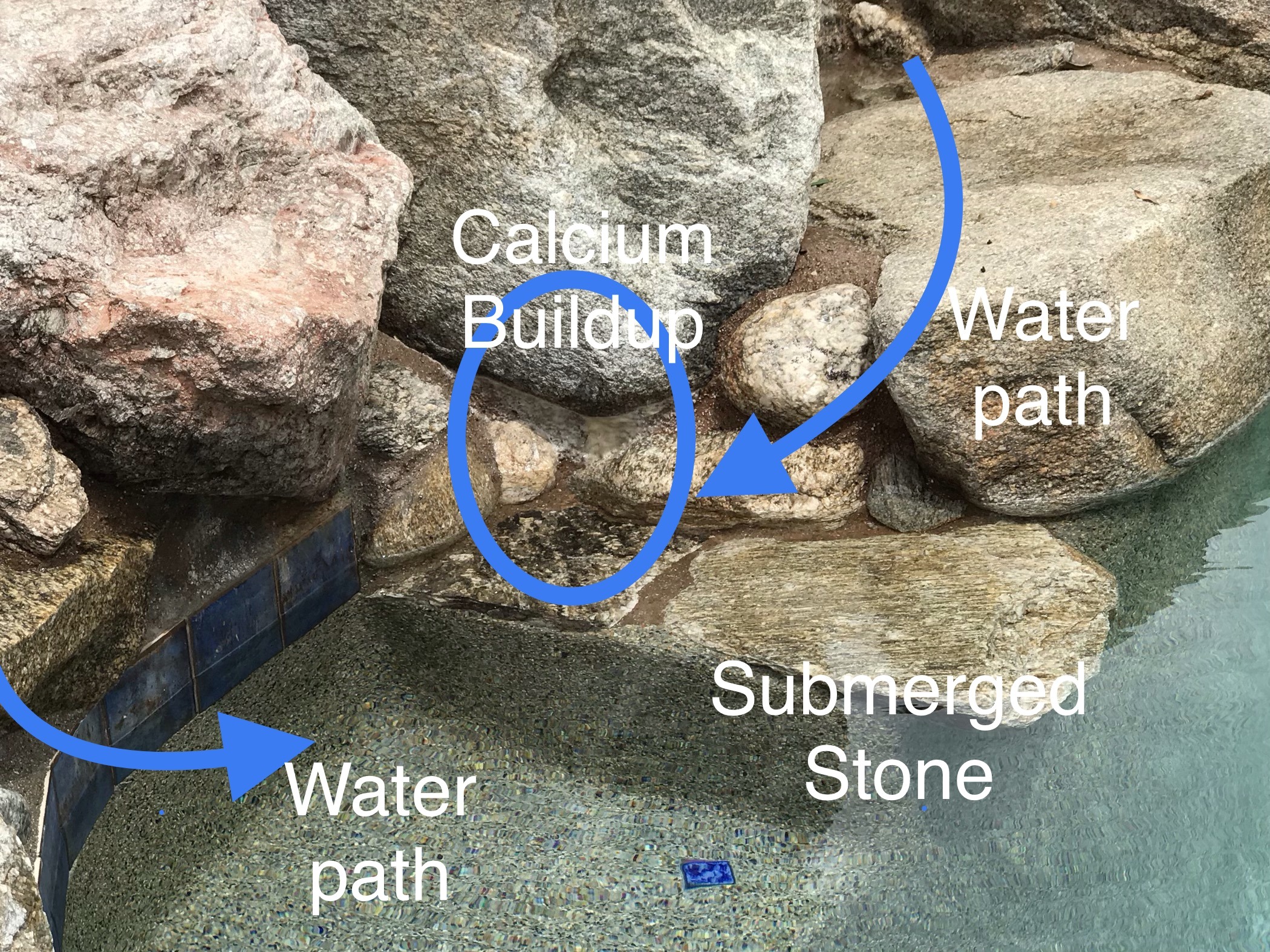

I was going to tag @MinerJason but he beat me to it! He’s an expert in cementitious materials and stone work.
I have boulders in my waterfall that we’re all locally procured from the Catalina range, mostly granite with a “red stone” or two but none of the reds are in the water path. However, when they did the exposure (acid wash) of my PebbleTec during install, they accidentally hit one of the rocks and it caused a stain on my wall. 6 years later and I can still faintly see it. So yeah, be very careful...

I have some similar stones like that in my waterfall. They are not on the water flow path but they do get wet. My pool has no detectable iron.
The trick is when the plaster contractor does the final finish, many of them use an acid wash procedure. That is when staining will be most likely to occur (splash out hitting the rock and then runoff onto the plaster). You’ll have to work with your plaster applicator and ask them to either be really careful OR do extra prep work to cover the rock. Offering to pay a little extra cash for the additional prep work will likely get you the best possible outcome.

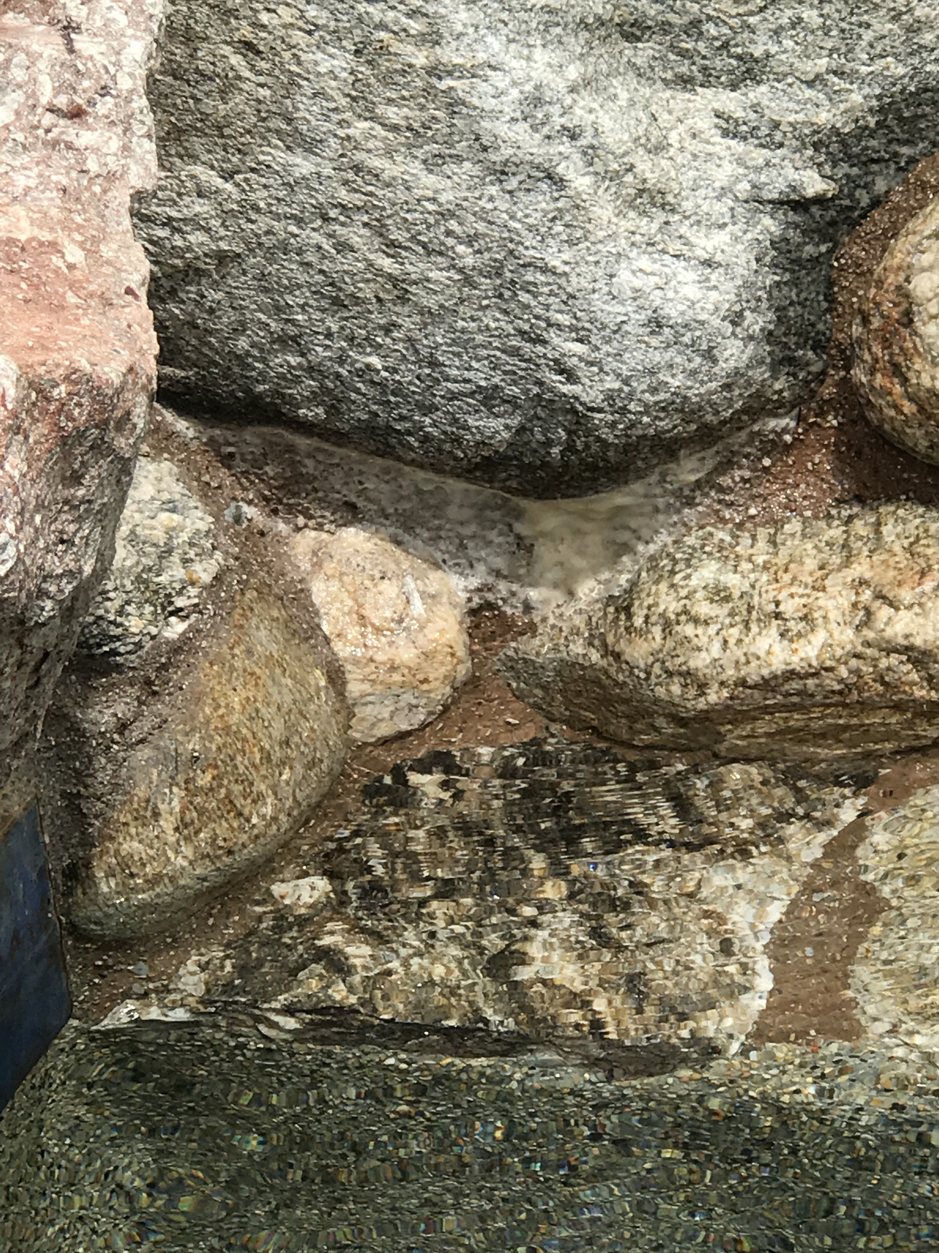

I would reiterate @MinerJason ‘s point about sealing the stone. If the any stones are going to be submerged or have water flowing over them or if multiple stones are going to be mortared together to form a water-bearing surface, then sealing them may be very worthwhile, especially the mortar joints. I have mortar joints that have held up very well BUT they tend to develop a thick calcium deposit due to the fact that the mortar is an alkaline substance and the high CH water that runs over it is constant going through a wet/dry cycle and thus depositing a fresh layer of calcium scale. So there are some patches along the mortar joints that have very thick, smooth, off-white colored deposits that are basically calcium carbonate with some trapped dirts (hence the off-white color). As gross as it sounds, it looks like a giant wad of mucus (I know, gross, but that’s the coloration and smoothness of it). It can be easily chipped off but, I bet if the mortar were sealed there, it wouldn’t happen as easily.
So, long story short, try to think of what your rock design and layout will be and then try to decide what you can do to minimize the impact of flowing water. We had a separate contractor that did the waterfall and he was really smart and knew his stuff because his whole business was building backyard koi ponds and river/water features. So he was well aware of all the pitfalls and intricacies of stone work.
